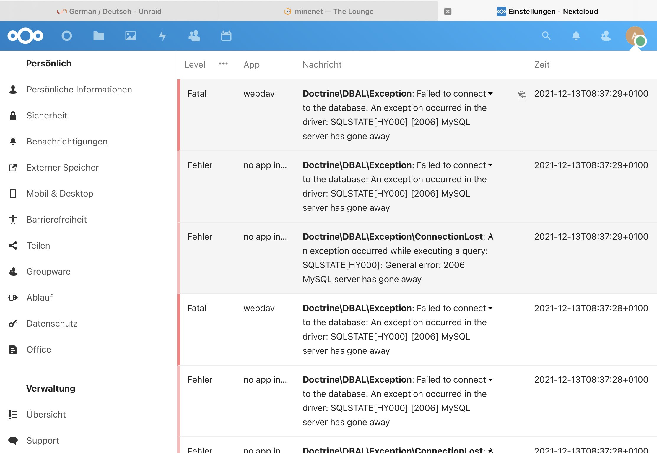

I had some cache pool upgrade issues and now am receiving this error in Nextcloud
"MySQL server has gone away in /config/www/nextcloud/lib/private/DB/Connection.php:87"
I tried poking around MariaDB's appdata to find an error log but was unsuccessful. I know nothing about MariaDB except follow SIO's videos.
Any ELI5 help is appreciated. I do have an appdata backup if it comes to that but figured there may be a more appropriate and better way to fix the issue.
TIA!
I just nuked it and restored from appdata backup. Not too awful of a loss. 3 days...

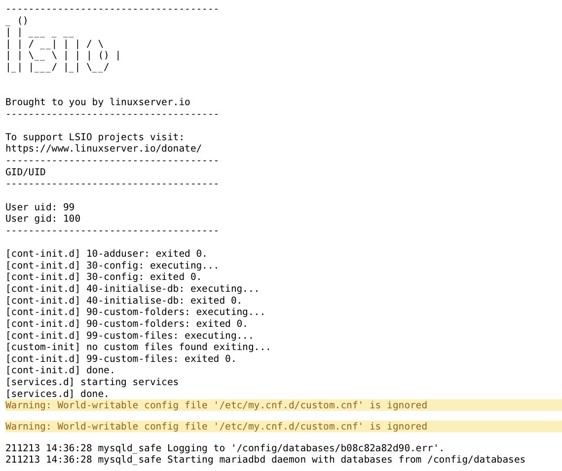

On 12/13/2021 at 3:56 PM, Anym001 said:
 I have the same MariaDB log :( :(  What should I do ?
I also have received the same error for the last few weeks sometimes. I was able to solve it with this command after looking into the .err logfile
2022-01-05 23:39:32 0 [ERROR] mariadbd: Can't create/write to file '/var/tmp/ibXXXXXX' (Errcode: 13 "Permission denied")
2022-01-05 23:39:32 0 [ERROR] InnoDB: Unable to create temporary file; errno: 13
chmod 777 /var/tmp

Hi! I upgraded my MariaDBs on Unraid, and now none of them will start. Apparently, just Clicking "Update" on the docker, does not gracefully shut-down Mariadb, but terminate it? So after the Update, the MariaDB now says "Upgrade after crash not supported" and then InnoDB wont start. This seems to be a quite common issue, but any way to firstly get this up and running?
Secondly, apparently just using the "Upgrade/Update" button on the MariaDB Docker in the Unraid WebGUI, isn't a good idea since it hard-kills the docker and then upgrades it, leaving perhaps un-applied redo-logs / unstartable docker? The mariadb will probably start if I just Delete the redo-logs, but I'd rather not? Hope one of you experts here can help me out. I'm no MariaDB expert, I usually stick to Oracle DB :)
Thanks :)
mariadb04_docker_log.txt
