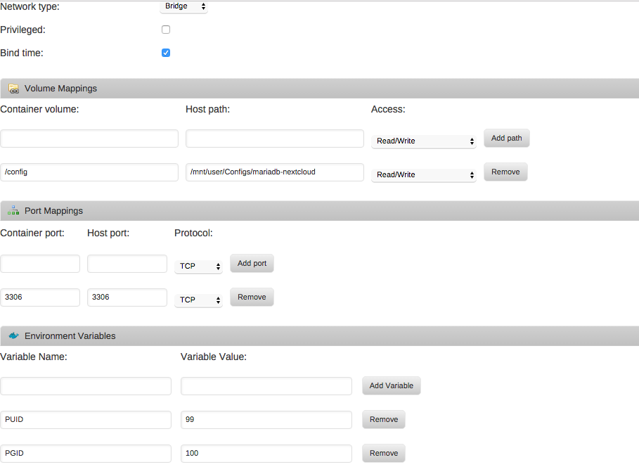

Successful installation of MariaDB on unRaid 6.1.9.  I'm able to access the container and execute commands.  FS running and I can see the default installation file structure.  All is well.
width=300http://my.jetscreenshot.com/12412/20160724-02gk-147kb.jpg[/img]
Then I try to connect to the MariaDB using SQLWorkbench (latest version) so I can setup some databases, etc.  But it won't connect.  I've verified the root password from within the MariaDB Docker...
When I try to connect I use Standard TCP/IP (all defaults) using the server IP name (I can access all the server resources from my Windows 10 64 bit machine).  It goes through a short process, then MYSQL Workbench crashes.
width=300http://my.jetscreenshot.com/12412/20160724-xf0w-68kb.jpg[/img]
What am I missing?  Is there some other security setup needed (SSH?)...
Thanks!
Well, all I can suggest is that you try HeidiSQL and see if you can connect with that.  If that works then it's a problem with MySQL Workbench config as HeidiSQL definitely works.
If HeidiSQL doesn't work then there's something not right with your config.
Just to check, you have specified the appdata share using /mnt/cache not /mnt/user haven't you?
Did you set the password in the gui?
Yep, set the pw in the GUI and the appdata is on the cache.  Is there some test I can run locally in bash to run and test the system?
I'll try hiedisql
Hmmm, appears to be a workbench problem.  HiediSQL connected immediately.  Ugh, now I have to learn a new tool!
