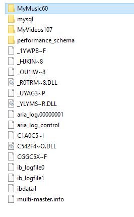

So this is what I have done so far;
Copied over the two most recent xbmc DB's using MC to appdata\mariadb
docker exec -it mariadb /bin/bash
mysql -u root –p
Enter password
CREATE USER 'xbmc' IDENTIFIED BY 'xbmc';  and press return
GRANT ALL ON *.* TO 'xbmc';  and press return
Close out the command line tool with \q
Close out the docker with \q
I can now connect via my MySQL app on my mac using the xbmc user and see the two xbmc DB's I copied over.
Just started my Kodi on AppleTV but it's not seeing the DB so I have some more work to do to find out why.
I think I'm on the right path....
