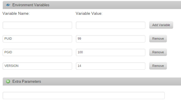

Mr. Balls - Is the VERSION variable something that you can set via the UNRAID web interface, or is that command line only? Can you see what version it's running from the web interface once the docker is up and running?
it's any version you want it to be from 14 to 16 (jarvis beta4) by setting the VERSION variable.
On Mr. Balls' behalf....  ;D
Click the advanced switch in the docker setup screen and add VERSION like below..
Awesome, thanks so much! I didn't realize there was an advanced view in the docker setup page.
