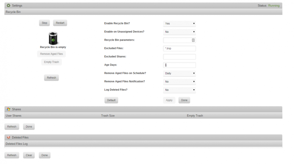

This is what you get when the array is stopped:
Looks like something in particular with your system.

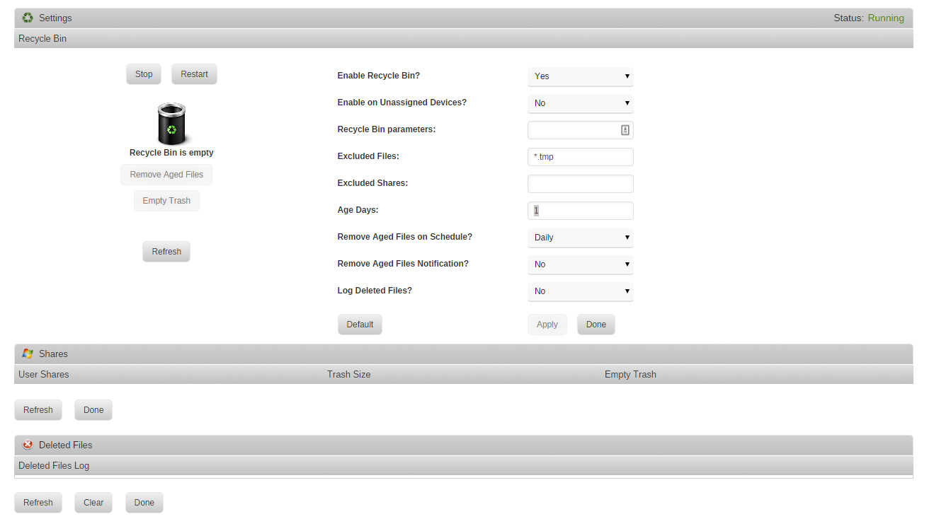

The recycle bin works only on unRAID SMB shares.  Show a screen shot of your unRAID shares and tell me which one doesn't seem to work.
Here's a screenshot of one of my shares.  There's no .Recycle.Bin folders in any share.  Deleting files don't show in that log.  I'm probably just doing it wrong but can't find anything on how to troubleshoot it.
