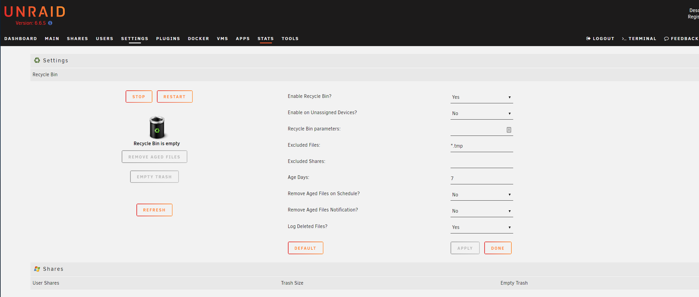

Virgin install on 6.6.5, recycle bin functionality works perfect as far as I can tell after running a few delete + empty tests, but the deleted file logging isn't coming up (yes it's enabled).
Screenshot of settings below, let me know if it's anything I've missed?
Thanks

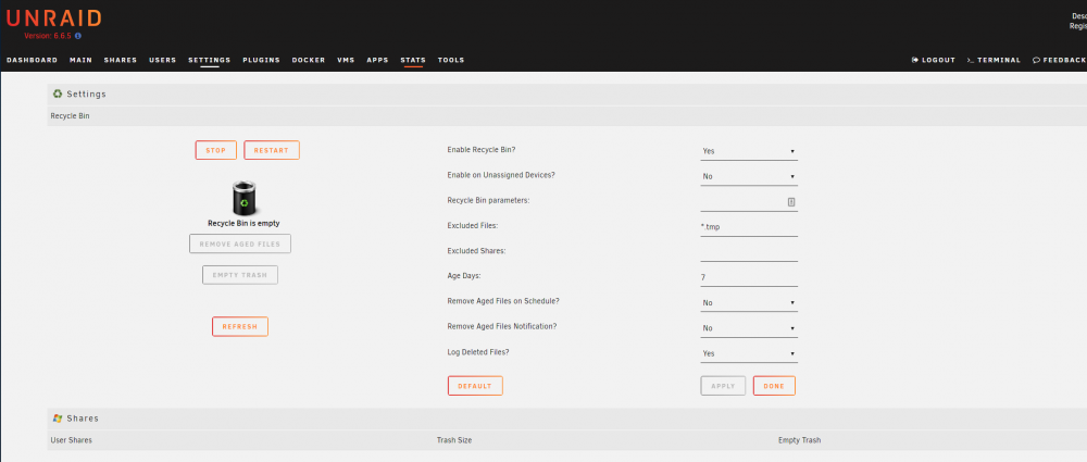

Thanks
Check the Settings->SMB->SMB Extras.  You should see this:
#vfs_recycle_start
#Recycle bin configuration
[global]
   syslog only = No
   log level = 0 vfs:0
#vfs_recycle_end
This sets the logging of the recycle bin.  See if there are any other global entries dealing with logging.
include = /etc/samba/unassigned-shares/downloads.conf
#vfs_recycle_start
[global]
   syslog only = No
   log level = 0 vfs:0
#vfs_recycle_end
Thanks for the help, only other entries are unassigned devices.
