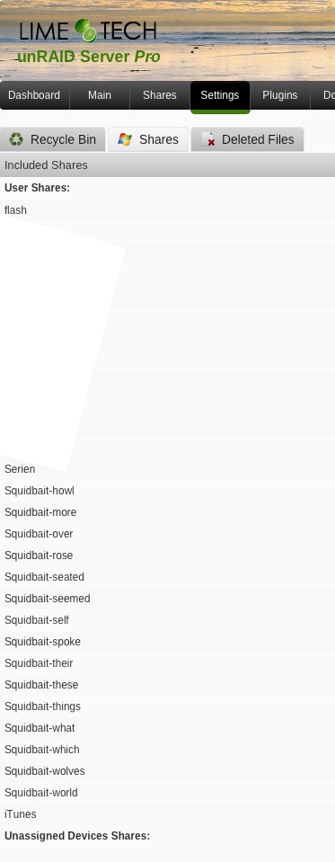

I really like the new "Exclude Shares" option. However the entry field seems to be limited. I was trying the exclude all Ransom Ware shares but it seems that they are too many. Is is possible to exclude all shares of these share with one single entry e.g. Squidbait* ?
I can expand the entry field, but entering all the shares that way seems tedious.  Let me do some research and try to find a way to exclude all the shares of the Ransom Ware plugin.  I'd be surprised if there were that many individual shares.
Can you post a screen shot of the Recycle Bin->Shares page so I can see how the Ransom Ware plugin sets up its shares?  Scroll the page to show the Ransom Ware shares.
Best way to exclude is to allow a regex / wildcard to be in the field (or a drop down).  Depending upon options, the folder names can be regenerated every boot and are completely random.  But I don't see how recyclebin would affect the moniitoring
Here you are ... I have already excluded as much as possible.
Thank you very much for looking into this.
I am changing the exclude share to act more like a wildcard exclude.  For example:
'Squidbait' will exclude all shares with the 'Squidbait' in the share name.  The comparison will be like the wild card 'Squidbait*'.
Awesome  :)
Update 2017.02.08 released.  You can now specify the excluded shares in a wild card fashion.  For example with the Ransom Ware plugin, you specify the excluded share as Squidbait.  All shares with the text Squidbait will be excluded.  There is additional write up on the OP.
