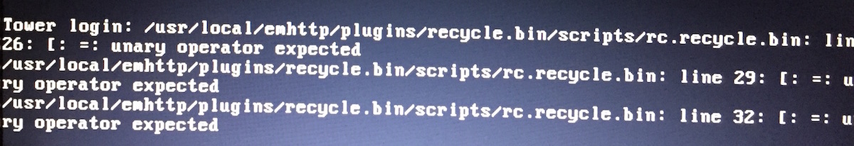

Since I updated to 6.2.1 I'm getting error messages when I boot.
/usr/local/emhttp/plugins/recycle.bin/scripts/rc.recycle.bin: line 26: [: =: unary operator expected.
The error is repeated three times for lines 26, 29, & 32.
I'm not sure if recycle bin is currently working or not.  The plugin is dated 2016.10.07

Fixed in latest release.
Thanks.  I just received the update.  I'll reboot in the morning.
