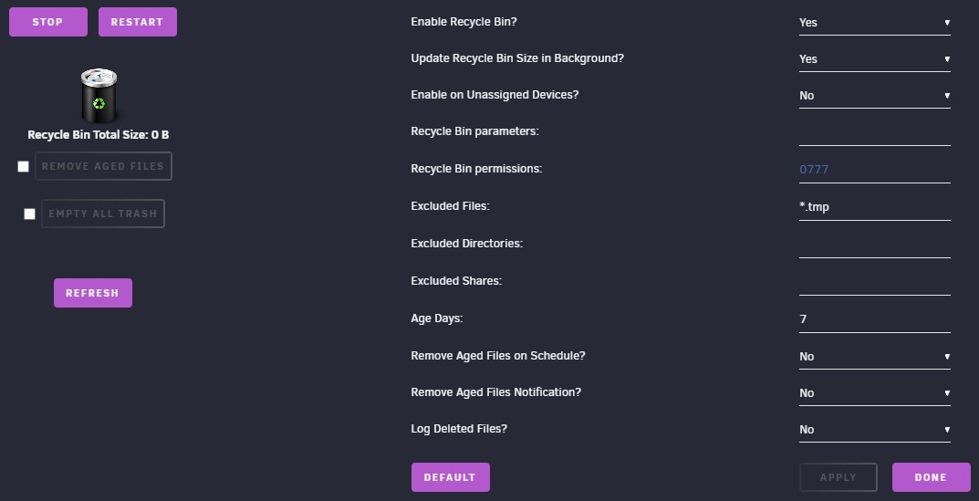

Post a screen shot of your recycle bin settings.

    Done.   The file directory in the recycle bin is created when the file is deleted so it will show the date/time when the file(s) were deleted, but the modify date/time on the files will rema

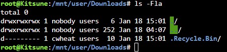

So, In regards to the newest update for the Recycle Bin. It appears that with the newest update, when the .Recycle.Bin folder is created, it appears the permissions are not set correctly when using the default settings
If you do a chmod 777 on the .Recycle.Bin folder, it works properly again. However, I'm used to deleting the folder when doing a cleanup and letting the tool recreate it each time; so this is a workaround for now.
I just found that bug and it will be fixed in the next release.
