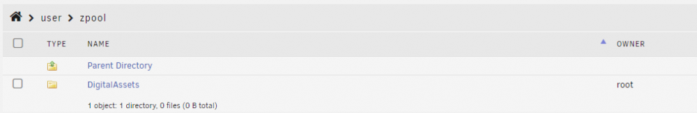

Great stuff! I am running into one issue, i followed spaceinvaders video for native ZFS and at the end he showed how to make a sym link. Which works... kinda. My total drivespace in windows shows up as only remaining disk space on trhe array drive that is used for apps and such, which is about 455 Gb left. When im trying to move my data back, im ruinning into an issue that im moving more stuff then 455 gig so windows just says no. The same issue is visible under my computer, where the share shows as only 455 out 480 free.
I did some test runs and everyhting works fast as expected, data is being moved to the ZFS drives, and the free space on array 1 drive  remains the same.
My question is, how do i get around this limitation and get windows to see that actual zfs space used and free and allow me to copy all my stuff back instead of the drive where sim link is originating from, sort of speak.
UPDATE: Im an idiot, mounted the top level zpool instead on zpool/folder in wiondows so it still passed data along, but calculated wrong thing. all shows up as its supposed to now. Willl leave this up in case someone else is half asleep doing this :)

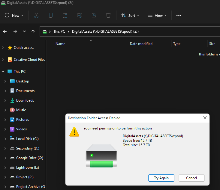

You are a God amongst men, thank you! I have an NVME drive that i was using as a boot drive for TrueNas that has no wear so i figured it wont hurt given how easy it is remove or add.
My last issue is tring to write to the pool. I did the sym link as per space invader. Under shares, after creating the sym link i made sure to make that share private, with read/write access to the user i created for this. I can mount the drive but i cant write to it. Gives me the permission error. I am stumped. I tried to do run tools/new permission but that didnt do anything so I am stumped.
Tried to do it with just public access and same issues :(

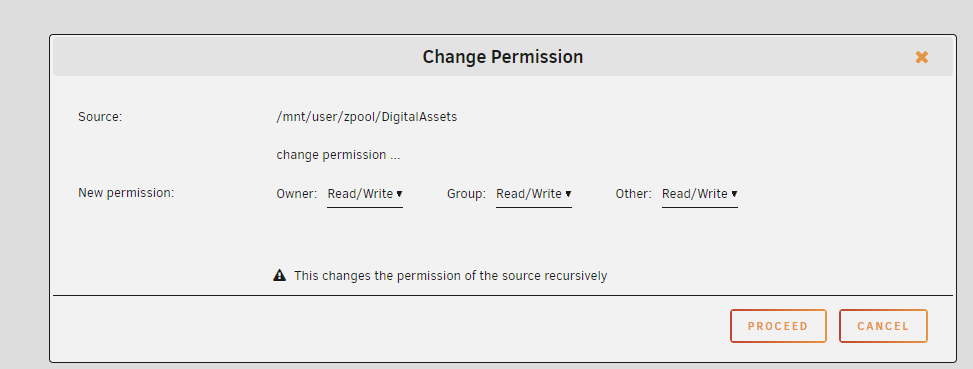

Update:
I tried to change the onwer of the DigitalAssets folder inside digitalassets/zpool to user trying to access it or nobody. Neither seems to stick. It reverts back to root.
I think i got it to work by editing permissions as follows below:
Is there a security issue if other is set to read and write? Thats the only way i got access to the drive.
Edited by TheEugeneKam
Update
No problem.  I haven't actually ever used the GUI options and my setup may be very slightly different.  For example when I create an array, I set the mount point of the array simply into /mnt - it seems like you've put yours into /mnt/user/zpool.  I am not sure if that's in a guide or what, but it doesn't seem like a sensible way of doing it as you may have permissions problems being that it's a user folder.  Also, clearly you're also talking about SMB sharing.  I found that the unraid smb sharing doesn't work with ZFS really, but luckily zfs has it's own SMB built in - so you can edit the smbextra file in /etc somewhere - sorry can't look it up exactly at the moment - I think it's like /etc/samba/smb.conf/smbextra.conf or something like that.  Don't worry the smb format has examples and is super easy.  Also for me, any zfs shares in unraid under /mnt I just set them to nobody.user and that sorts them out.  having them as root definitely doesn't work.  Just always bear in mind with linux, folders must always be set to 777, and the files can be whatever you need.  Hope that sort of points you in the right direction.
Something else to note - since you're on linux AND sharing out over SMB, you'll want to ensure you've aclmode set to passthrough, aclinherit to passthrough-x, and likely want to set xattr to 'sa' if not already done (make sure it's at least not set to 'off').
