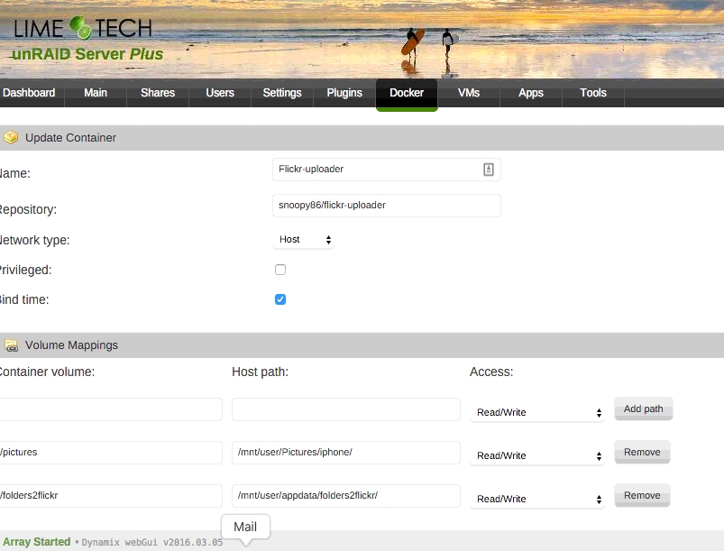

flickr uploader doesn't start (i have put the edited .ini file in the folder as instructed)
the log file is empty.
are there any parameters that should be edited in the file apart from the key and secret?

Unraid log isn't important. Only the log from the docker.
Do you have variable PYTHONUNBUFFERED set to 0?
yes.
i removed the docker and the "my-flickr-uploader" template, installed again from your template, still the same.
I really can't see why it wouldn't work. Post print-screen of your template.
here, attached.
bump... any ideas why this doesn't work for me?
Could you start container in a unraid terminal and attach to it. Inside you will find the script and try to run it.
i'm willing to try it but don't know how - i've only used the docker from gui so far. i can use the terminal but i'm unfamiliar with docker in cli.
