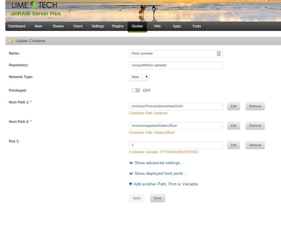

Hi, trying Flickr uploader again i managed to get it to start. when i go to the URL from the log, i get redirected to the flickr home page without anything else happening. is this app still active?
here's the log details:
*** Running /etc/my_init.d/00_regen_ssh_host_keys.sh...
*** Running /etc/my_init.d/uploadr.py...
--------- Start time: Wed Dec 13 13:56:27 2017 ---------
Setting up the database: /etc/my_init.d/flickrdb
Completed database setup
Error: {u'stat': u'fail', u'code': 98, u'message': u'Invalid auth token'}
Getting new token
Copy-paste following URL into a web browser and follow instructions ( you have 60 seconds! :) ):
https://api.flickr.com/services/auth/?perms=delete&api_key=430ebc476e2f5a61ffcf3fcea5312848&frob=72157690287682334-3b3306f5acd7676b-335468&api_sig=8d48a0efcf947c6f84d407aae2d1d601
Waiting0
Waiting2
Error: {u'stat': u'fail', u'code': 108, u'message': u'Invalid frob'}
*****Removing empty Sets from DB*****
*****Completed removing empty Sets from DB*****
*****Adding Flickr Sets to DB*****
{'nojsoncallback': '1', 'format': 'json', 'perms': '', 'auth_token': 'None', 'api_sig': '639833d751d809c50f8ae50ba2eca295', 'api_key': '430ebc476e2f5a61ffcf3fcea5312848', 'method': 'flickr.photosets.getList'}
*****Completed adding Flickr Sets to DB*****
*****Uploading files*****
Found 0 files
*****Completed uploading files*****
*****Removing deleted files*****
Getting new token
https://api.flickr.com/services/auth/?perms=delete&api_key=430ebc476e2f5a61ffcf3fcea5312848&frob=72157689516299841-23630d17417164eb-335468&api_sig=4a37538c3d60e811460b49db82668c24
Waiting0
Waiting2
*****Completed deleted files*****
*****Creating Sets*****
*****Completed creating sets*****
*****Adding tags to existing photos*****
*****Completed adding tags*****
--------- End time: Wed Dec 13 13:59:26 2017 ---------
*** Running /etc/rc.local...
*** Booting runit daemon...
*** Runit started as PID 10
Dec 13 13:59:26 Tower syslog-ng[15]: syslog-ng starting up; version='3.5.3'
and here's a screenshot of the docker settings:
i figured it out, flickr uploadr requires a pro account now.

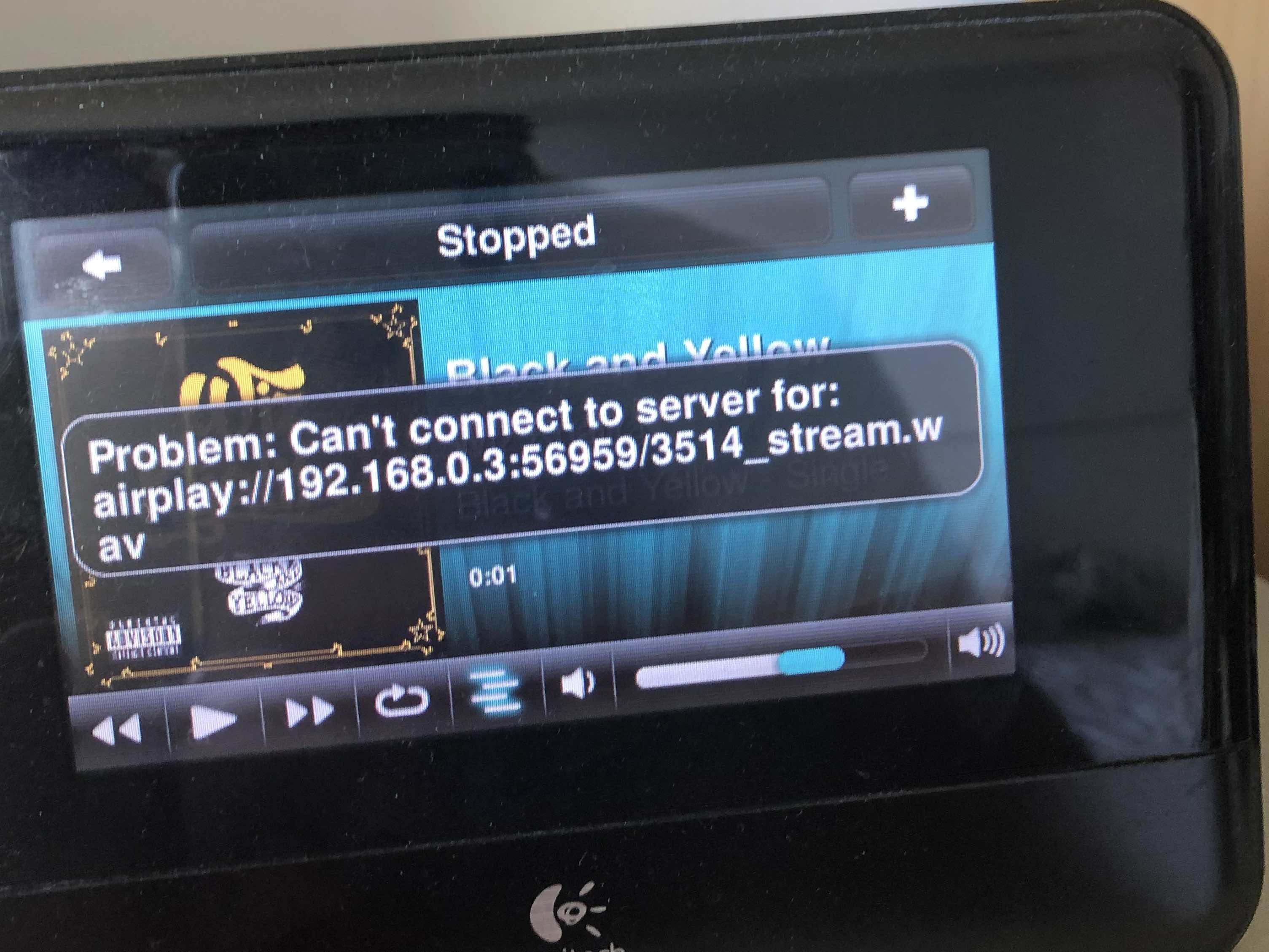

Thanks for your work on this docker Snoopy86 - I use it daily and did even contribute via paypal once!
However, since the 8.0 update (I think - the timing seems to be right) I get errors when I try to send airplay from my phone to one of the players (using shairtunes2 plugin). The player gets all the metadata and tries to play the stream, but can't seem to connect back to the server. Have you seen this?
I checked and the shairport is listening on the port that the player is trying to connect (I was surprised to see it uses a random port which isn't explicitly mapped in docker, but it seems to - and I can manually connect and retrieve the stream from a remote command line (using http).
Any ideas?
