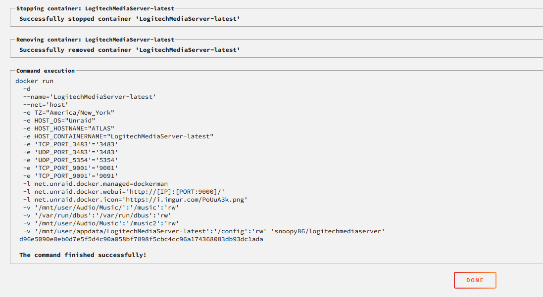

I have successfully started the LMS docker and accessed the WebUI.  However, there is no /music directory (host -> container) available. I have tried adding a second path to an alternate /music2 container directory and its also not visible. Before I got the container working/webui accessible, I had to change the permissions of the config directory.  Is there some other permission I need to change?
Edited by GalloLoco
add pic
post docker run

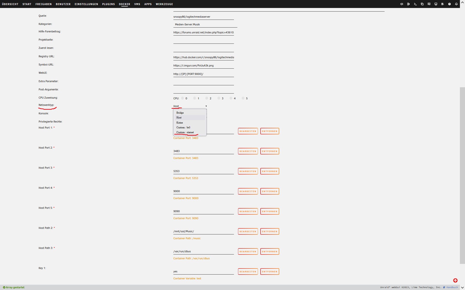

Hello,
I have created a user-defined network (starnet) as recommended in which all my dockers run, only the LogitechMediaServer reports "Installation failed" after the corresponding setting under network type and the network type: "Bridge" is not possible, only "Host" is accepted.
Can someone please explain this to me or is there a solution?
Many thanks!
