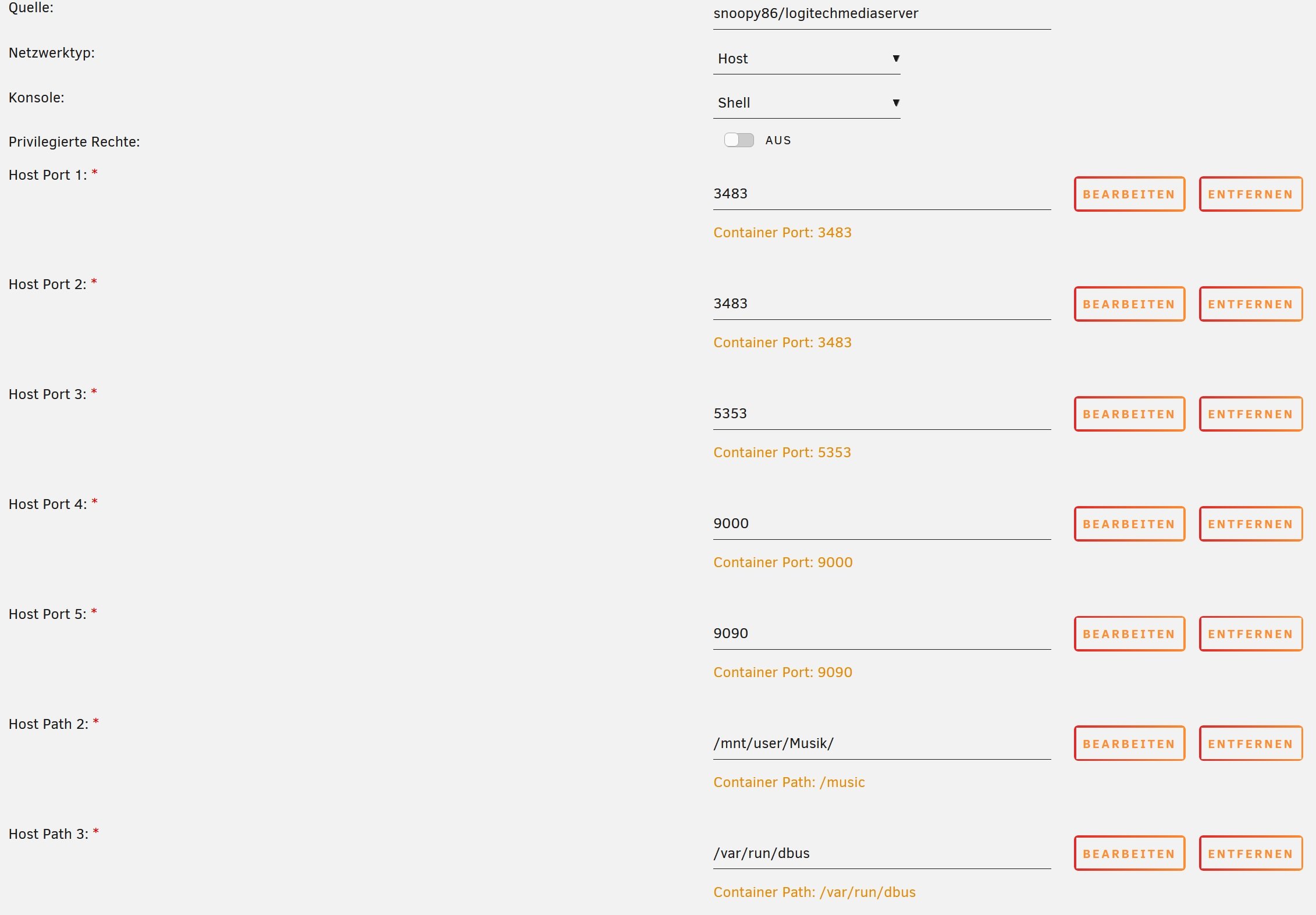

Is your docker network type set to Host?
Also, check your permissions. I like you had an older install that worked - check my previous post a page back.

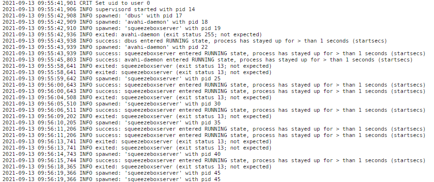

Hello everyone, new to the forum but using Unraid sinse 2017.
I´m also having the same issue reported previously by @Marbles_00
Here is screen from the log i have ...
This is a infinite loop, and i see that the CPU is working on this process over and over...
I want to point out that the docker was working just fine before I just automate the update. I am not sure when it stopped working as i didnt use LMS lately, and sometime from the last time i used to date, I haven't been able to access the Web GUI. The log above is pretty much what I get whenever I try to turn the container on, even after a server reset.
I tried to force update LMS (Im on LogitechMediaServer latest -- brench), remove and reinstall LMS and no luck. I also tried to install the other LMS version (not the "latest" brench) and nothing :(.
My network type is set to "host". Also the port 5353 (default) was conflicting with Plex so I changed it to 5354.
I tried to change the network type to Bridge, didnt work as well.
Doxdump replayed Marble_00 post asking to check the folder permission though i'm not sure how to do it, Im pretty good that following guides, though Im not a linux guy.
Any idea how to sort this out?
