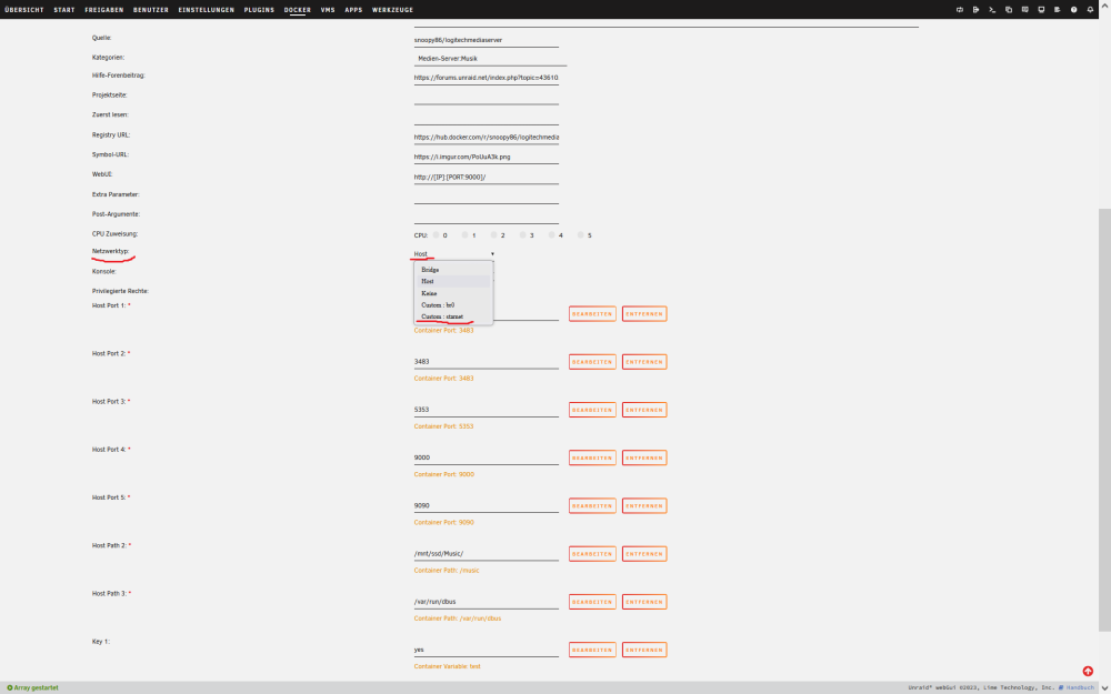

  • looks like a new install is not setting the proper permissions:   root:root rwxrwxr-x /LogitechMediaServer-8.0/cache root:root rwxrwxr-x /LogitechMediaServer-8.0/logs root:root rwxrwxr-x /L
  • Is your docker network type set to Host? Also, check your permissions. I like you had an older install that worked - check my previous post a page back.

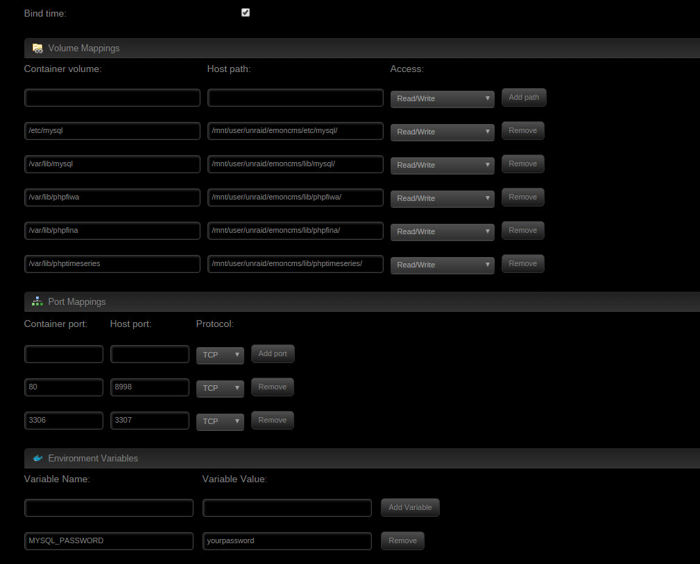

I pointed all the volume mappings to a folder called emon on my cache drive.Below is the list from the Docker page.:
/var/lib/phpfina    /mnt/cache/apps/Docker/apps/emon/
/var/lib/phptimeseries    /mnt/cache/apps/Docker/apps/emon/
/etc/mysql    /mnt/cache/apps/Docker/apps/emon/mysql
/var/lib/mysql    /mnt/cache/apps/Docker/apps/emon/mysql
/var/lib/phpfiwa    /mnt/cache/apps/Docker/apps/emon/
This is probably hopelessly wrong. Could you let me know what I need or where to find info? Most installs 'probably' aren't like unRaid so being a novice and a User rather than a developer shows my limits!
Firstly put your mappings in seperate folders. I see that you have some mappings in the same folders...
How is your port mapping. Do you maybe have any other docker with mysql running on 3306 port?
