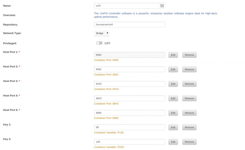

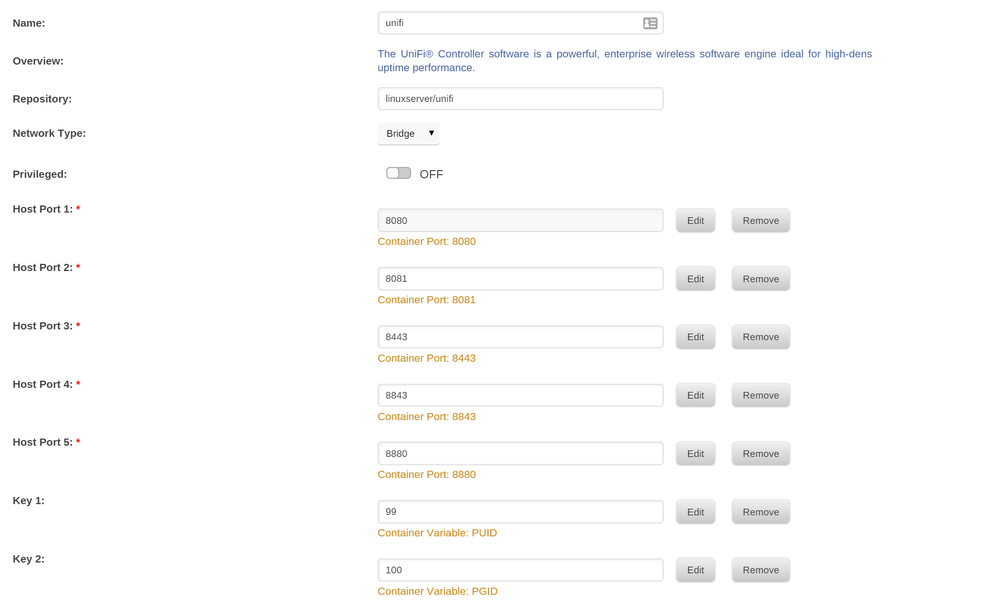

I'm struggling getting the Docker controller to see the Unifi AP.
I ran through the process of logging into the AP and running the set-inform command, but still nothing. set-inform http://serverIP:8080/inform
The only way I get it to show up in the Docker controller is if I run it using Host instead of Bridge. In Host mode, I'm able to see the AP and that it's managed by another controller. In Bridge, I don't see any APs.
Any advice would be appreciated. I've attached my Unifi Docker Config.
Edited by NNate
I went into Host mode, adopted the AP and then switched back to Bridge. Everything looks good now.
