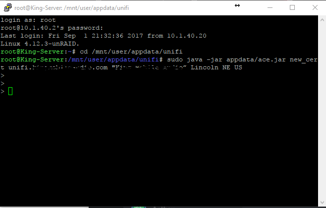

i've tried following this video. the file system doesn't match to unraid
i'm really new to this type of stuff.
I followed his video, these are the commands I've ran
cd /mnt/user/appdata/unifi
sudo java -jar appdata/ace.jar new_cert unifi.domain.com "Company” Lincoln NE US
it should ask for password
and all i get is  >
Edited by H2O_King89
Try doing it from within the docker container
docker exec -it unifi bash

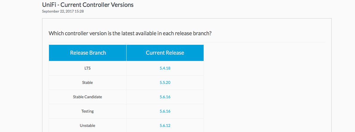

Anyone successfully updated to 5.6.16?  Want to be sure there are not gotchas before I do.
I have but I use a different docker
From the looks of it, this docker image does not appear to be pulling the latest 5.6.16.
It pulls the latest release each week that is in the stable Ubuntu Xenial PPA. Unifi are responsible for updating that PPA so if it's not up to date, there's nothing we can do.

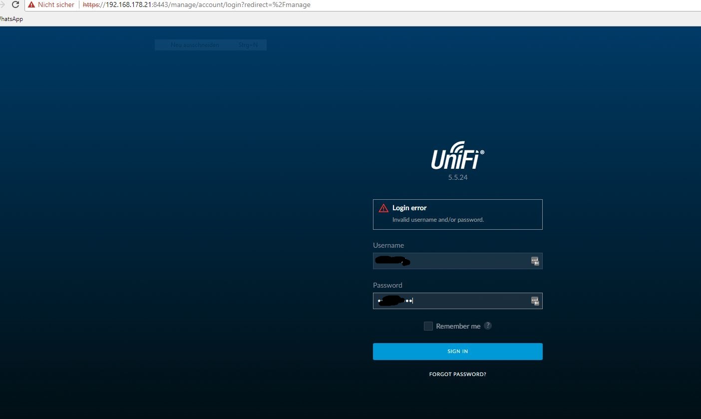

Hey guys,
i need some help setting up this docker.
So i just got my unifi equip. and installed this docker.
So far so good
But i cant login - tried reinstalling etc - nothing works
any ideas what might be wrong ? (yes username and password is 100% correct)
No error messages in the logfile

I'm having the same problem.
any solution so far?
thank you.

Ensure you have the correct credentials that you set during the setup phase and that you don't have capslock on/off or numlock on/off whichever is appropriate to your chosen password,, and or clear browser cache / cookies etc.
Spun up new instance of this image and set a password and logged in with no problems whatsoever
