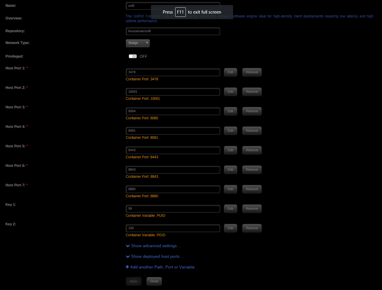

Hi, i need help, can't add my UniFi AP-AC-Pro to the controller
I added the Unifi docker to my unraid server, I see my AP but when I try to addopt it says Adopting failed, I try to add it into my old windows controller and it works, I also upgraded my ap to the lastest version 3.9.15.8011
I also tried to reset my ap to default factory 2-3 time, someone can help me !
I have no error im my log:

Have you tried setting the docker to Host mode instead of Bridge mode until devices are adopted?  You can then set it back to Bridge after all devices are adopted.  That's what enabled me to be able to adopt new devices with this docker.
A colegue of work told me to add the ip address of my controller in my unified router into the DHCP. Otherwise I do not have port 8080 by default which can cause a problem. Also I could connect in the terminal in ssh and make the command
set-inform http: //172.16.82.5: 8084
I will try when I'm at home
