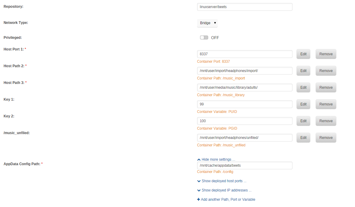

Can anyone help me please? So i have created the 3 directories and mapped them but if i try to run 'docker exec -i -t Beets bash' i get the message 'Error response from daemon: No such container: Beets'
So none of the commands seem to work for me.
docker exec -it beets /bin/bash -c 'beet import /music_unfiled'
-it not -i -t
-it not -i -t
Ahhh!! thanks for that.
