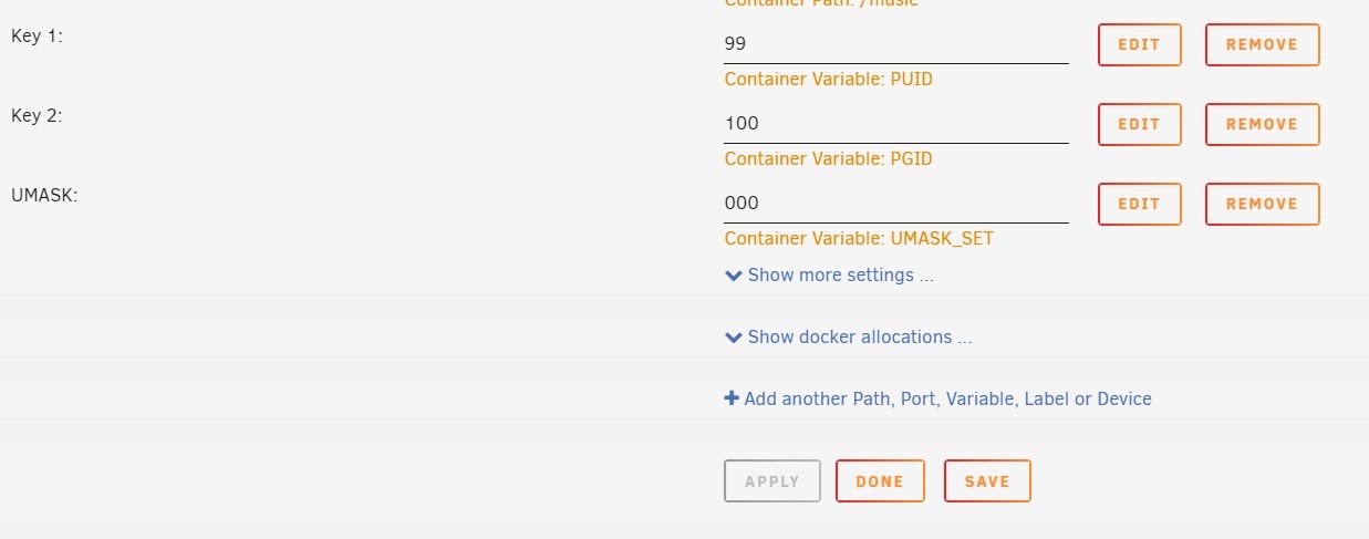

Hey guys. I've used both this docker and thetarkus version and they both exhibit this problem. When importing new files, when beets moves/copies them to the destination, the file ownership is root.root - even though the docker settings for UID/GID is 99/100. This requires me to chown/chmod after each import in able to edit the files later on. Short of writing a cron job, is there a way to fix this? Or does beets support a post-processing script (I couldn't find anything in their docs) that can call external commands? Any help would be appreciated.
You have probably not used -u abc when you execute the command to import the music. Then you run beet as root and your files will end up with root:root permissions.
You have to run it as abc as that is mapped to 99/100.
docker exec -u abc -it beets the command to import

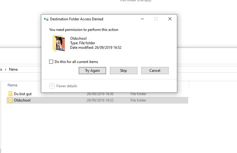

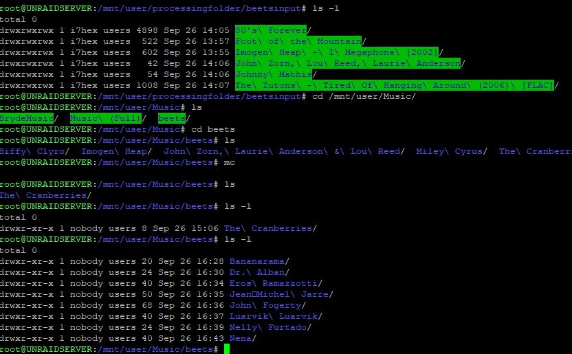

also, I am unable to modify the folder/files created by beets on my Windows desktop machine, I can access the beets source folder ok it's only after beets has processed them that I can't.  can anyone help with that please as have to keep using crusader or chmod
Thank you

*UPDATE*
It looks like it is the file permissions rather than the folder permissions that are the problem?
