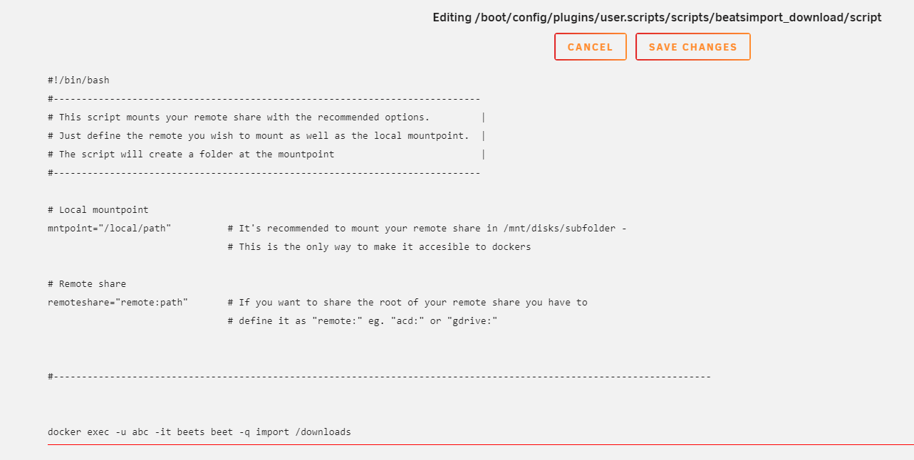

that permissions plugin did not work for me so I ended up creating a cron job to chmod the folder every minute to get around that issue.  The one I am hoping to find an answer for was regarding the automation?  I tried creating a cron job to run hourly in user scripts but nothing happens, although the command works fine from the console (docker exec -u abc -it beets beet -q import /downloads) so it is probably my stupidity and lack of knowledge stopping it from working! 🤔

1 hour ago, mbc0 said:
Hi @saarg sorry if I offended you, certainly not my intention, I am well aware of what you do and please don't think it is unappreciated.
Not offended at all. Just explaining why we do not always answer right away.
I never used beets and haven't tried the plugin, but it will only work on music you import after you enable and configure the plugin.
so the existing files you have to chmod.
I can't answer about the automation at all as I don't use it and my servers are still down after lightning struck nearby.
If it works using the command line, there is something wrong in the script. If you post it here, someone might be able to see the issue.

I am aware that it will only work on music I have imported, I am trying the permissions file again, I think I see where I went wrong!
this is how I configured my script but as I say it just does nothing... I know that the line works as it is what I use to import manually, I guess I am missing something but I have managed to create successfully several other scripts that work fine.

7 minutes ago, mbc0 said:
Thanks for your time @saarg
Try to comment out the mount points.
It might be that you need to use the full path to the docker bin or need to quote the command.

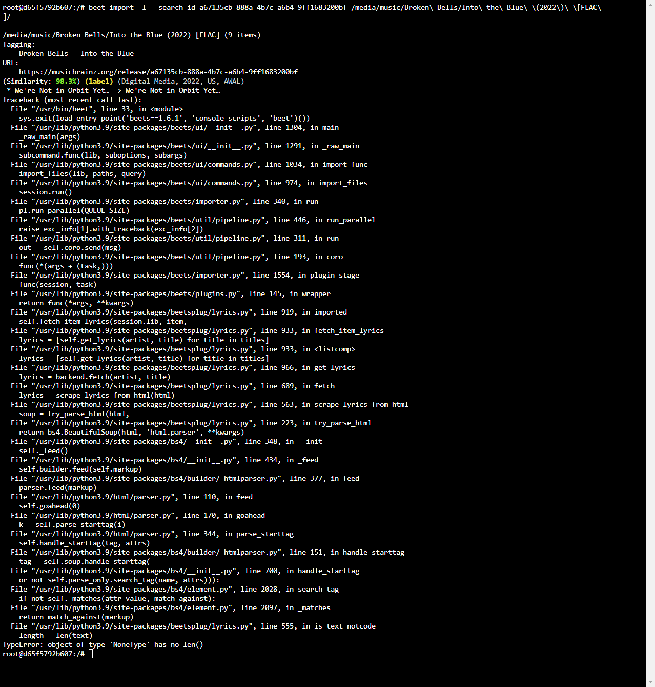

when trying to import genres with lastgenre, I get the error lastgenre: last.fm error: NetworkError: [Errno 99] Address not available. Anyone was able to use lastgenre with this container?

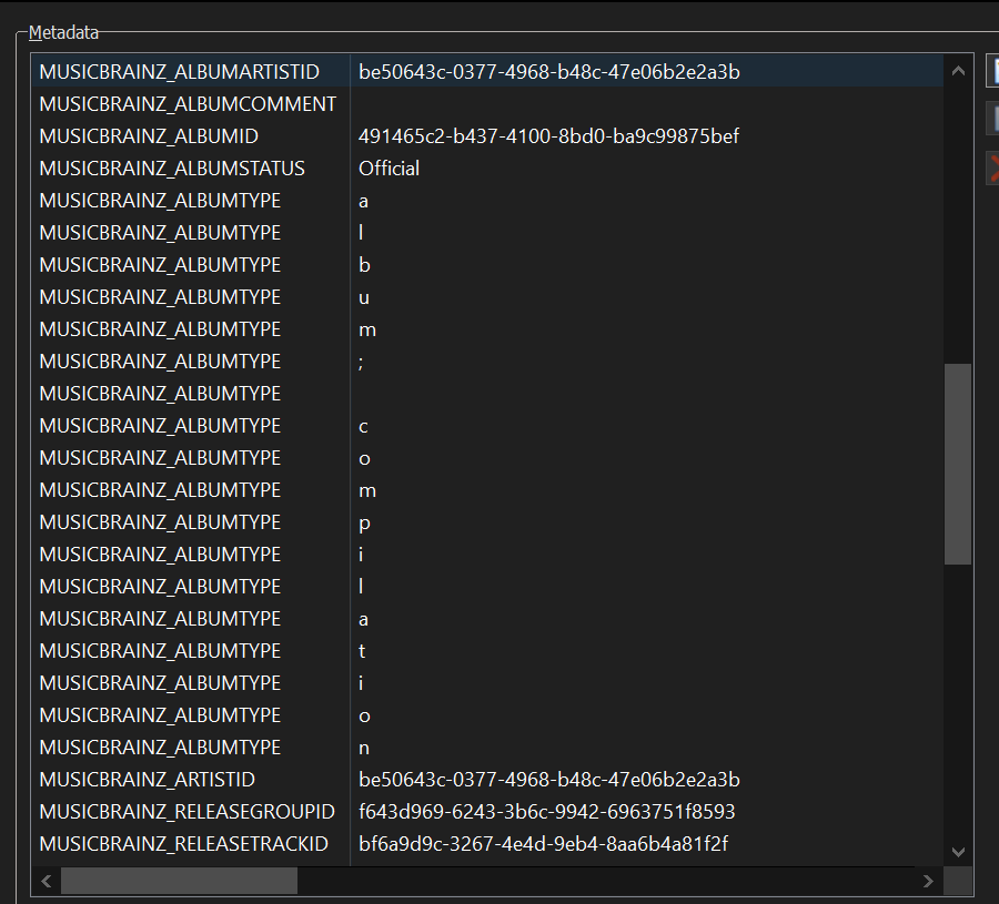

I've noticed that all of my files have the field 'albumtype' separated into individual entries for each letter.  albumtype: a, albumtype: l  et cetera, creating many entries for something like 'album; compilation'
A google search yielded this:  https://github.com/beetbox/beets/pull/4582#issuecomment-1445023493
After doing 'beet write' to an album the files still show the same issue, even though beets said it was writing the corrected tags (I had tested with --pretend first)
My database appears to be good, it is the files themselves with the bizarre tagging.  A pretend 'beet update' shows that it would be writing the bogus tags into my database.
Perhaps I don't understand the directions in the fix linked above, or is the issue that this docker container does not include the amended code?  Thanks for any help
