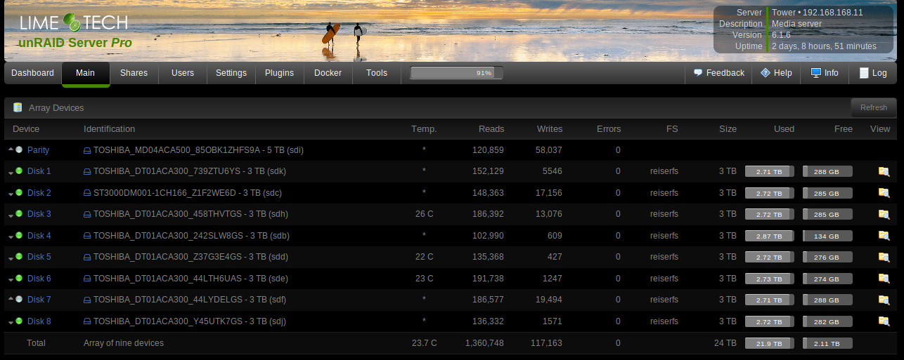

Update: Doesn't matter if on motherboard or the addon cards.  Also, its not spinning up to get temps as the drives are active but no temps reported for some of them as seen in the screen shot.  If I do a manual spin up or use the drive, the temps are reported as normal.  Running 'smartctl -i -n standby /dev/sdX1' reports ACTIVE OR IDLE for those spun up and STANDBY for the drives spun down.
Still doing it.  Spun up 3 & 4 this morning when loading tower/main.  It never showed drive temps for the drives it spun up.  Is it querying drive smart data on load?  Is there source code available for main?

Not interested in the disk temps, they report normal when drive is spun up manually or for normal file access.  When main loads it will sometimes spin one or more drives up, but even though it spun a drive up for no reason it will not report the temp for it no matter how many times page is refreshed.  It will report when the drive is accessed for a file or manually spun up. Temps are not my concern, the lack of reason for spinning up drives just to view the GUI a couple times a day is.  It appears to be some sort of smart query, but there are passive ways to check if the drive is spun up and act accordingly.
