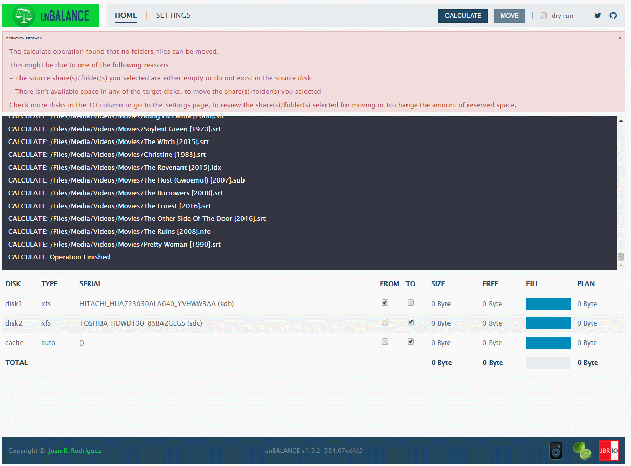

I updated to 1.5.2 but now I can't calculate the moves. unBalance is showing 0 bytes across the board for my drives and shows what you see in the attached image. Also, I never noticed it before, but my server's console shows this after boot:
/bin/bash: line3: /usr/loval/emhttp/plugins/unbalance/scripts/stop : No such file or directory found
EDIT: Attaching my log.
unbalance.zip
I have the same 0 byte issue on 1.5.2...
That seems like a typo /usr/loval/emhttp/. Should read /usr/local/emhttp/  :o

Mybad, it was local, (I was typing that from a KVM console, not a copy/paste). I'm also still getting exit error 23.
Seems like it is erroring with status 23 due to a leading slash in the relative path, and thus is cannot find the source path...
ie. in the logs it has:
rsync -avRX --partial "/Other/.AppleDB" /mnt/disk3/
but it should be:
rsync -avRX --partial "Other/.AppleDB" /mnt/disk3/
