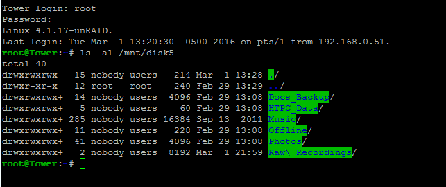

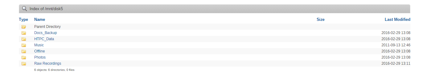

lboregard,
Attached is a screenshot of the
ls -al /mnt/disk5
The shares are not there?  I did not see any errors in the logs either which is why I am confused.
If disk5 did not have the folders for the user shares ISOs, SageTV, Recovered and lost+found, would it have created them?
Dan
lboregard,
ls -al /mnt/disk5
Dan
That's strange. I'll send you a pm.

I just wanted to post an update that I discovered a corruption on disk5, after running xfs repair my missing files returned under the lost+found folder.  Here is a link to that other thread:  http://lime-technology.com/forum/index.php?topic=47092.0
Still trying to understand the root cause, but wanted to provide feedback.  lboregard has been great with followup via PM!
Dan
