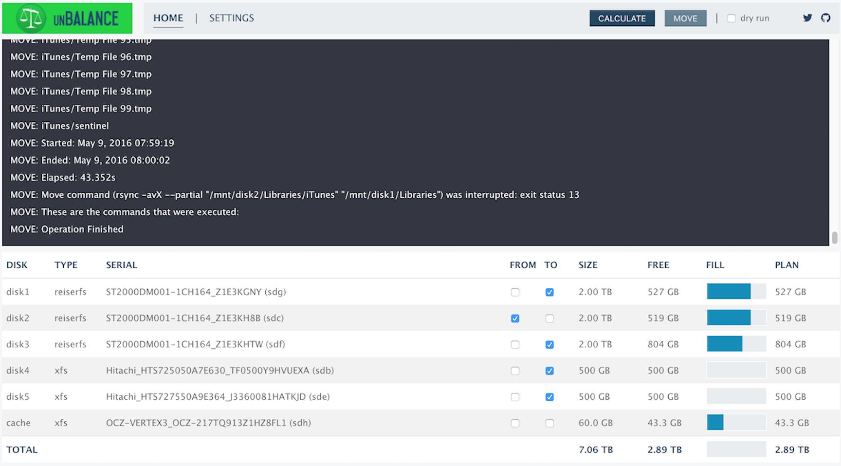

Can someone explain why this happens every time I invoke a move. See attachment.
It calculates and does a dry run happily.
Hi rmeaux, there have been previous reports about issues with Apple files (such as your iTunes library).
If you have your unbalance log (/boot/logs/unbalance.log), pls send them over (pm if you want).
