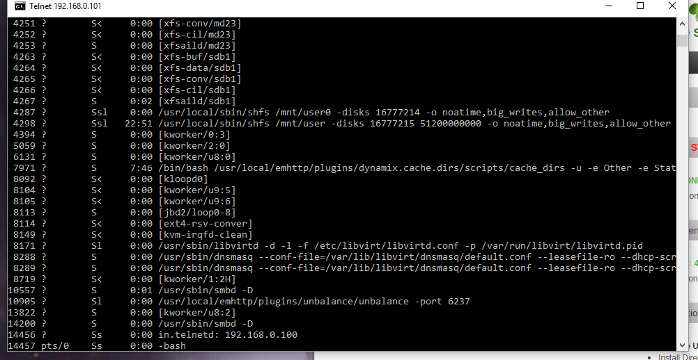

I actually have an issue now. The plugin is refusing to calculate, it just sits there forever processing. Tried restarting the entire server 2 times to make sure it wasn't some hanged process.
EDIT: Restart the plugin a bunch of time, checking same boxes from disk 4 to disk 14, pressing calculate, etc. Then it randomly worked on the ~5th try of doing the exact same process. *shrug*

The above problem where it just sits there forever "calculating" came back and it just wouldn't stop. Restarted the server 3 times, restarted the plugin even more times, no idea why it happens or how it fixes itself. No one else has this happen?

Wonder if the plugin isn't receiving the command when I click the button?
I deleted the log, restarted the plugin again, and it started working again. I have no idea why that would fix it, may be unrelated. Though, the last time I had this happen I did the same thing and I'm pretty sure it fixed it then too. Really strange, wonder if it's caused by the log getting too big.
Doing it again. :(
Stopped plugin, deleted log, started plugin, added share, then clicked calculate. It's sitting there doing the calculating animation, the cmdline box doesn't pop up at all. The plugin does not acknowledge I hit the calculate button according to the log. I can't seem to fix it again, even after a complete server restart. The only way to fix it seems to wait a random amount of time.
What I am doing is checking 1 "from" disk, and unchecking all but 1 "to" disk. Not sure if this is the cause, because the plugin insists on rechecking all the "to" disks whenever I change the "from" disk. When it starts working again, i'll leave all the "to" disks checked and see if it still happens.

Doing it again. :(
Which browser are you using ? Can you try from a different one ? (I haven't had any problems with Chrome)
Doing it again. :(
Your right, it actually is caused by using firefox it seems.
I thought it could be something like that. I'll look into it.
Hmm, it's still happening on Chrome.. but it's different. When I click "calculate" nothing happens at all now (no calculating animation icon, nothing). After that, the whole WebUI does not work, all the buttons do nothing. Restarting the WebUI fixes it, but hitting calculate once again just makes it all stop working again. Tried reinstalling the plugin, same thing.
