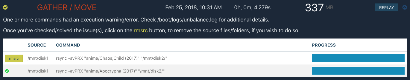

v2018.02.27 (5.0.0) is out !
This release improves rsync execution handling.
Any rsync command that generates a code 23 error will be flagged and the source files/folders it refers to, will not be deleted.
Use the History page and the log file (/boot/logs/unbalance.log), to check which commands had issues and act accordingly.
Once the issue is solved, you can remove the source files/folders, using the 'rmsrc' button in the History page.
Also, although the rsync default flags are the same (-avPRX), you can now remove the 'X' flag, if you want.

For some more context, this is the log where a command has been flagged:
I: 2018/02/26 15:25:13 core.go:682: Running Move operation ...
I: 2018/02/26 15:25:13 core.go:705: Command Started: (src: /mnt/disk1) rsync -avPRX "anime/Chaos;Child (2017)" "/mnt/disk2/"
W: 2018/02/26 15:25:13 shell.go:51: flagged:(rsync: opendir "/mnt/disk1/anime/Chaos;Child (2017)" failed: Permission denied (13)
W: 2018/02/26 15:25:13 core.go:746: command:end:error(exit status 23)
I: 2018/02/26 15:25:13 core.go:750: command:retcode(0):exitcode(23)
I: 2018/02/26 15:25:13 core.go:995: Command Finished
I: 2018/02/26 15:25:13 core.go:1008: Current progress: 28.21% done ~ 1s left (293.21 MB/s)
W: 2018/02/26 15:25:13 core.go:927: skipping:deletion:(rsync command was flagged):(/mnt/disk2/anime/Chaos;Child (2017))
I: 2018/02/26 15:25:13 core.go:705: Command Started: (src: /mnt/disk1) rsync -avPRX "anime/Apocrypha (2017)" "/mnt/disk2/"
W: 2018/02/26 15:25:21 core.go:795: getReadBytes:err(open /proc/7011/io: permission denied):xfer(0)
I: 2018/02/26 15:25:21 core.go:750: command:retcode(0):exitcode(0)
I: 2018/02/26 15:25:21 core.go:995: Command Finished
I: 2018/02/26 15:25:21 core.go:1008: Current progress: 100.00% done ~ 0s left (65.05 MB/s)
I: 2018/02/26 15:25:21 core.go:939: removing:(rm -rf "/mnt/disk1/anime/Apocrypha (2017)")
W: 2018/02/26 15:25:21 core.go:984: skipping:prune:(/mnt/disk1/anime)
I: 2018/02/26 15:25:21 core.go:1074:
unBALANCE - MOVE operation completed
Started: Feb 26, 2018 15:25:13
Ended: Feb 26, 2018 15:25:21
Elapsed: 8.077s
Move operation has finished
Transferred 546.31 MB at ~ 64.50 MB/s
The rsync command was flagged because of permission issues. So, the source folder (/mnt/disk1/anime/Chaos;Child (2017)) wasn't deleted.
You could solve permission issues and run the operation again, or deal with it however you find appropriate.
The history page will show an yellow warning color for the operation and an 'rmsrc' (remove source) button for the flagged rsync command (shown in the attached image)
Once you have solved the issue, you can remove the source folder using the button.
Let me know how this works for you.
