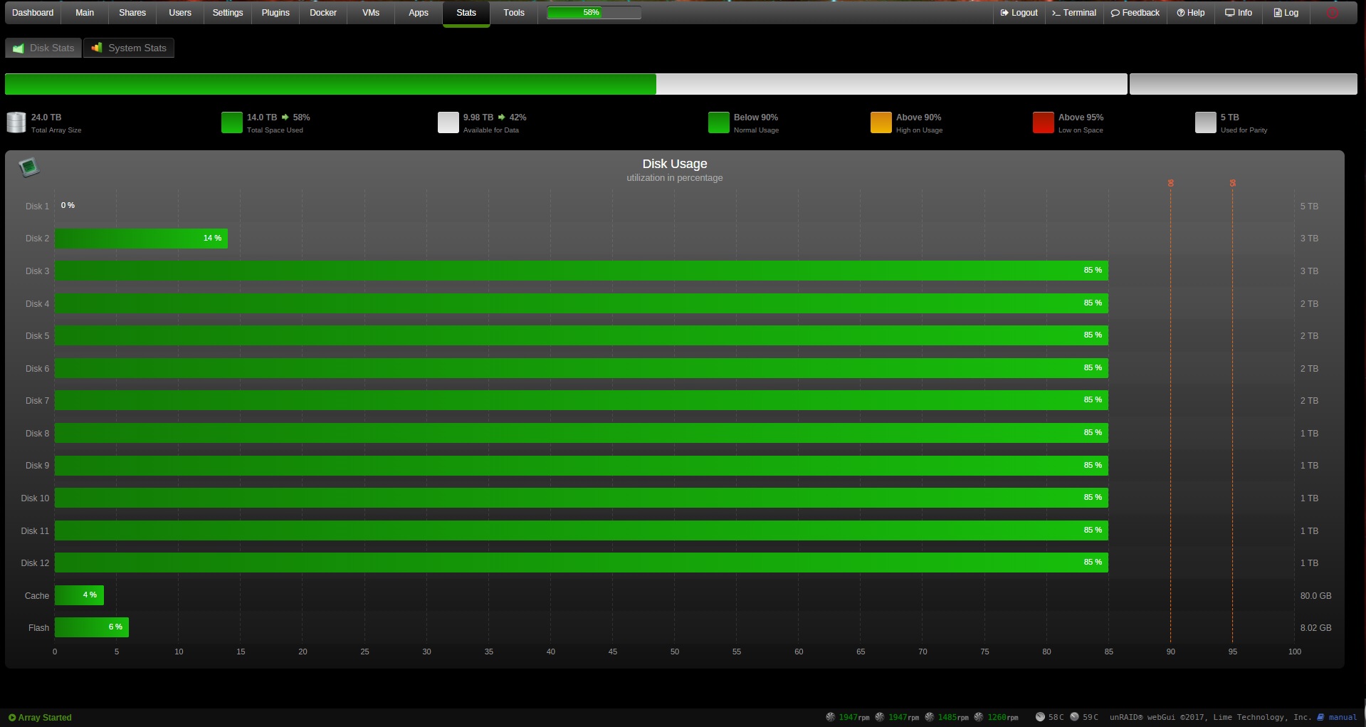

What would you suggest filling the available hard drives to?
I have my array set to fill approx. 85% of my drives....
