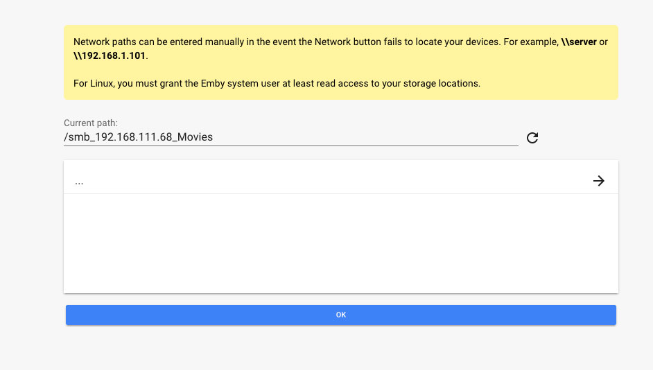

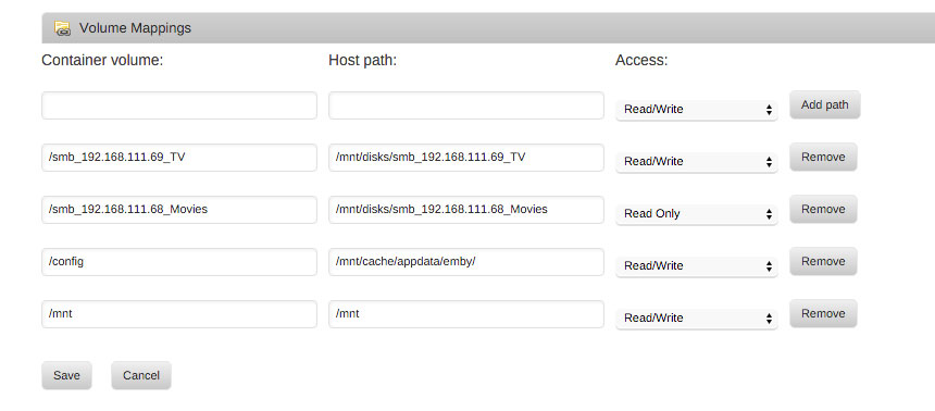

I am trying to add my media libraries on my second UnRaid server as network shares but I am unable to do it for some reason. I am adding \\IP address\share name but it keeps kicking it back to me, these are not open shares and perhaps that is the problem, they require a user name and password usually. I have added them as remote shares using the unassigned devices plugin, even copying and pasting the mount point into Emby, it takes it but cant access it. Is there a way to do what I am trying to do?
Ash, mount it in unassigned devices, then map it in the docker configuration.  Not sure how well it'll work with the share security though..
I can't seem to get it to work, I can add the path to the docker but when I add it to Emby it doesn't scan it, although it doesn't complain about being able to access, it doesn't seem to be able to.
AM
AM
docker has a problem where if the mount points aren't available when the service starts up, no container can see what's inside them
Stop and start the docker service, and hopefully everything will be ok.
(This problem is why I manually issue the mount commands for smb shares in my go file - so that on a restart they work)
Yup that worked, thanks Squid and CHBMB!!
