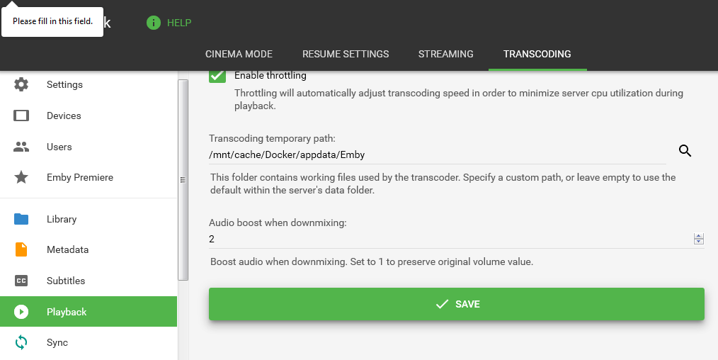

I have a strange issue. When I'm in the manage section, under playback, then transcode. If i try to make any changes and click save. it says "Please fill in this field" but it's pointing to the top left of the screen. i don't see any section that isn't filled out. It won't save, if i move to a different tab and go back it forgets all of my inputs. Anyone else experiencing that? i've tried restarting emby to no avail. I'm on the latest version (3.0.5986.0)
Is that using the iPad app? If it is I went though the same issue. I had to change it from my laptop (win 7). It might have been the other way round now I can't recall - it didn't work on one of my devices that's for sure lol.
Pretty certain it involved safari though  :)
No, this is on a Windows 7 laptop. i tried it in Firefox, Chrome and IE and all are doing the same thing.
Just rechecked and yes you're right I couldn't get it to change in Win 7 on Firefox or IE.
I used the iPad app to make the changes. There are issues with the web ui loading in Safari on the iPad too which I know have been mentioned on the Emby forum.
I knew I'd experienced it in some combination, I was trying to change the transcoding directory when I came across it.
Thanks for checking. Glad it's not just me :)
