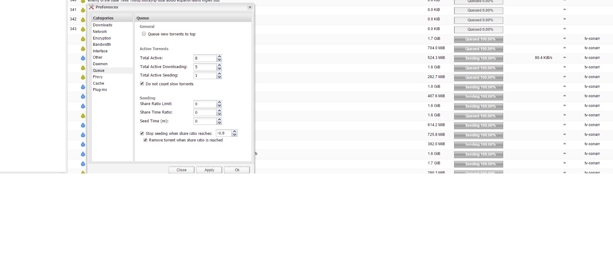

Also when I try to delete the torrents 100% of the time if I delete more than 3 at a time deluge will crash and require a restart to come back. If i delete them 1 by 1 it will eventually crash and come back on its own and a very odd time require a restart.
Your share ratio limit is -0.9, try a positive number?
this was just recommended by binhex. ill try it though
I  have mine set to 0.01
Unfortunately this doesnt seem to have worked.
Deluge is slow to stop and delete torrents i think, try to let it stay over the night.
