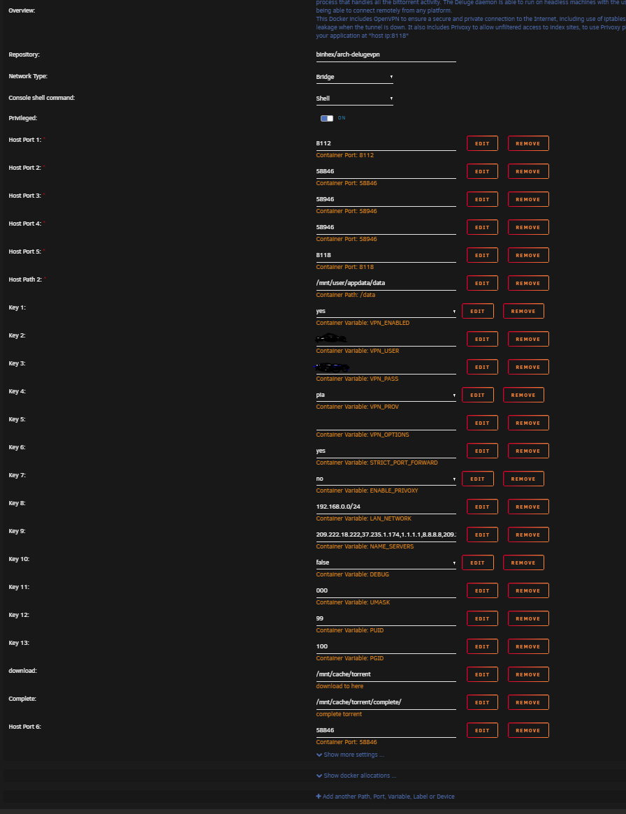

Possible someone has some insight as to not able to access the webui?  Have had delugevpn working for perhaps 2 years (works great!), with PIA.  the webui stopped working in the last few weeks.  The webui will come up if I toggle VPN_ENABLED to no.  I noticed PIA updated the .OVPN files a week ago - placed the new .ovpn (Vancouver) and crt/pem files in the openvpn folder.  Tried France as well (both listed as supporting port forwarding.).
Here are the settings:
The log file:
The log file:

Comcast is screwing with you and hijacking your DNS query for the end point, you need to get that turned off.
Sent from my CLT-L09 using Tapatalk
ok.  set DNS on router and the docker to just use google dns (8.8.8.8,8.8.4.4).  Same outcome.  Put static IP for the PIA server in the .ovpn file, but the log gives the port forwarding error (tried both vancouver and montreal, which are listed as supporting port forwarding), but webui comes up.  Preliminary research shows I'd probably need a router to support DNSmasq to get past comcast highjacking the dns request.  Are you aware of an alternative?  Thank you for the help!

Do you have or are you using a 3rd party VP’? The vpn site you are using might not support port forwarding.  That’s what the logs tell me.
1. You chose pita as your vpn and you are using a site that doesn’t support port forwarding.
