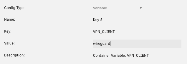

Hi Binhex, I'm having a bit of difficulty using wireguard (with mullvad). I've managed to get the container working with openvpn by following this post:
But I've had no success when I switch from openvpn to wireguard. So far I've tried the following:
  1. Enable privileged, change 'VPN_CLIENT' to 'wireguard', and append extra parameter
    --sysctl="net.ipv4.conf.all.src_valid_mark=1"
  2. Generate and copy my wireguard configuration file to /wireguard/, which I rename to 'wg0.conf' (although I doubt that matters). I implemented some of the suggestions you made in earlier posts, so my conf file looks something like
    [Interface]
    PrivateKey = <private key>
    Address = x.x.x.x/32,xxxx:xxxx:xxxx:xxxx::x:xxxx/128
    [Peer]
    PublicKey = <public key>
    AllowedIPs = 0.0.0.0/0
    Endpoint = y.y.y.y:zzzzz
Since I'm using wireguard, I shouldn't need the openvpn files. However, if I remove the files in /openvpn/, the container almost immediately fails:
2020-10-20 21:49:51.578271 [crit] No OpenVPN config file located in /config/openvpn/ (ovpn extension), please download from your VPN provider and then restart this container, exiting...
If I include the openvpn config files, the container starts successfully. However,  I can easily verify (by using https://ipleak.net/ and setting the wireguard/openvpn configs to different regions) that the container is just using openvpn, not wireguard.
Is there something else I can do to force the container to use wireguard instead?
i would suspect you havent defined VPN_CLIENT correctly, see this post:-
https://forums.unraid.net/topic/75539-support-binhex-qbittorrentvpn/?do=findComment&comment=902637

Thanks for getting back to me so soon! Unfortunately, that doesn't seem to be the issue. I have the key (not name) set to 'VPN_CLIENT' and the value set to 'wireguard', but the container still fails with the same error. image.png.4b41f1628b5e7c7165fb9c23353328eb.png
2020-10-21 06:47:01.678693 [info] System information Linux xxxx 4.19.107-Unraid #1 SMP Thu Mar 5 13:55:57 PST 2020 x86_64 GNU/Linux
2020-10-21 06:47:01.696537 [info] PUID defined as '99'
2020-10-21 06:47:01.715871 [info] PGID defined as '100'
2020-10-21 06:47:02.009384 [info] UMASK defined as '000'
2020-10-21 06:47:02.026586 [info] Permissions already set for volume mappings
2020-10-21 06:47:02.046493 [info] DELUGE_DAEMON_LOG_LEVEL defined as 'info'
2020-10-21 06:47:02.064229 [info] DELUGE_WEB_LOG_LEVEL defined as 'info'
2020-10-21 06:47:02.082173 [info] VPN_ENABLED defined as 'yes'
2020-10-21 06:47:02.104528 [crit] No OpenVPN config file located in /config/openvpn/ (ovpn extension), please download from your VPN provider and then restart this container, exiting...
Edited by radiation.syrup
Add full log, add image
then i can only assume you are not running the latest image, what is set for 'repository' for the container?.
The repository is
binhex/arch-delugevpn:1.3.15_18_ge050905b2-1-04
Just now, radiation.syrup said:
The repository is
yep thats the problem, you are using a tagged version, you need to drop the tag (the colon and everything after it) in order to download the latest image, this will of course mean you will move onto deluge 2.x
Ah ha, of course! Yes, I switched back to Deluge 1.3.15 for compatibility reasons. I'll give the new version ago. Thanks!
