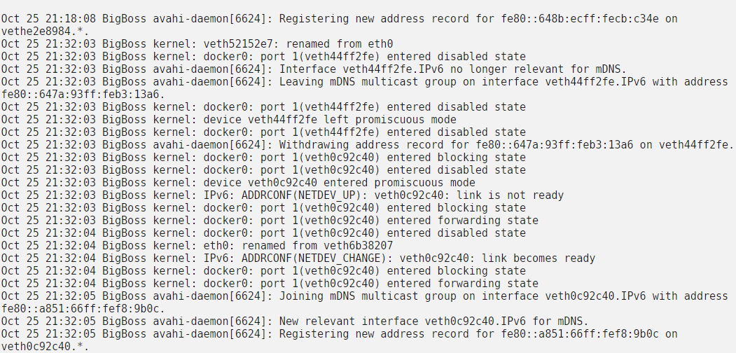

So after having to change my ISP gateway to bridge mode and back due to a technical issue with work computer, it seems that I have broken a few of my dockers including Deluge and nzbgevpn. I can no longer access those dockers as when I click on WebUI the page says This site can’t be reached, refused to connect. I tried changing the openvpn end points for deluge, it did not work. then I lost docker service, restored it, but still can't open deluge or nzb..
I can't figure out if its due to the recent change made by PIA or something on my end. can anyone point me in the right direction..
i have attached my dx file. and screen shot of the system log
bigboss-diagnostics-20201025-2339.zip
