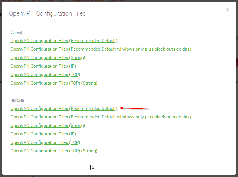

1 minute ago, Magic815 said:
Hmm. Is the config you grabbed, this one? I just tried it again, copying all 3 (cert, pem, and one .ovpn) and still the same cipher error. Which .ovpn file did you choose?
Yes that's the one, I'm using Romania, as it supports port forwarding.
Interesting. So I just tried it with Romania - but had no luck. But then I went in and added the line from the FAQs A22, to the Romania file. And now it works!
I'm not sure if certain locations are just not working, or if it had to do with where I put the cipher-fallback line, but it's working for me now! Very curious that you didn't need to add the line, but oh well!
Appreciate your help @binhex and @diditstart!
I'm running into the same issue and have tried all of the same steps you have, including the one you had success with, but unfortunately have had no luck.
