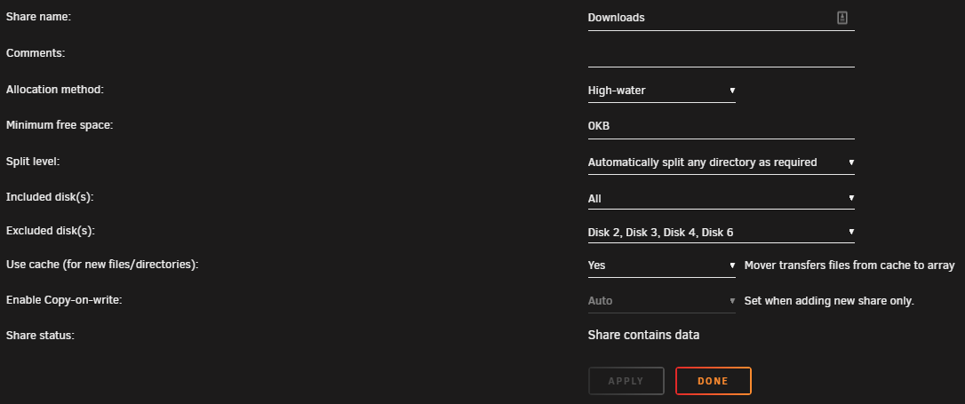

3 hours ago, Kishin said:
Hello, does anyone has a script to move files between disks ?
I would like to download to my cache then move them to the array where i can continue to seed / hardlink for plex.
Thanks.
In my setup I rely on the nightly mover to move my downloads from the cache to the array.  This occurs every day at 04:00.
