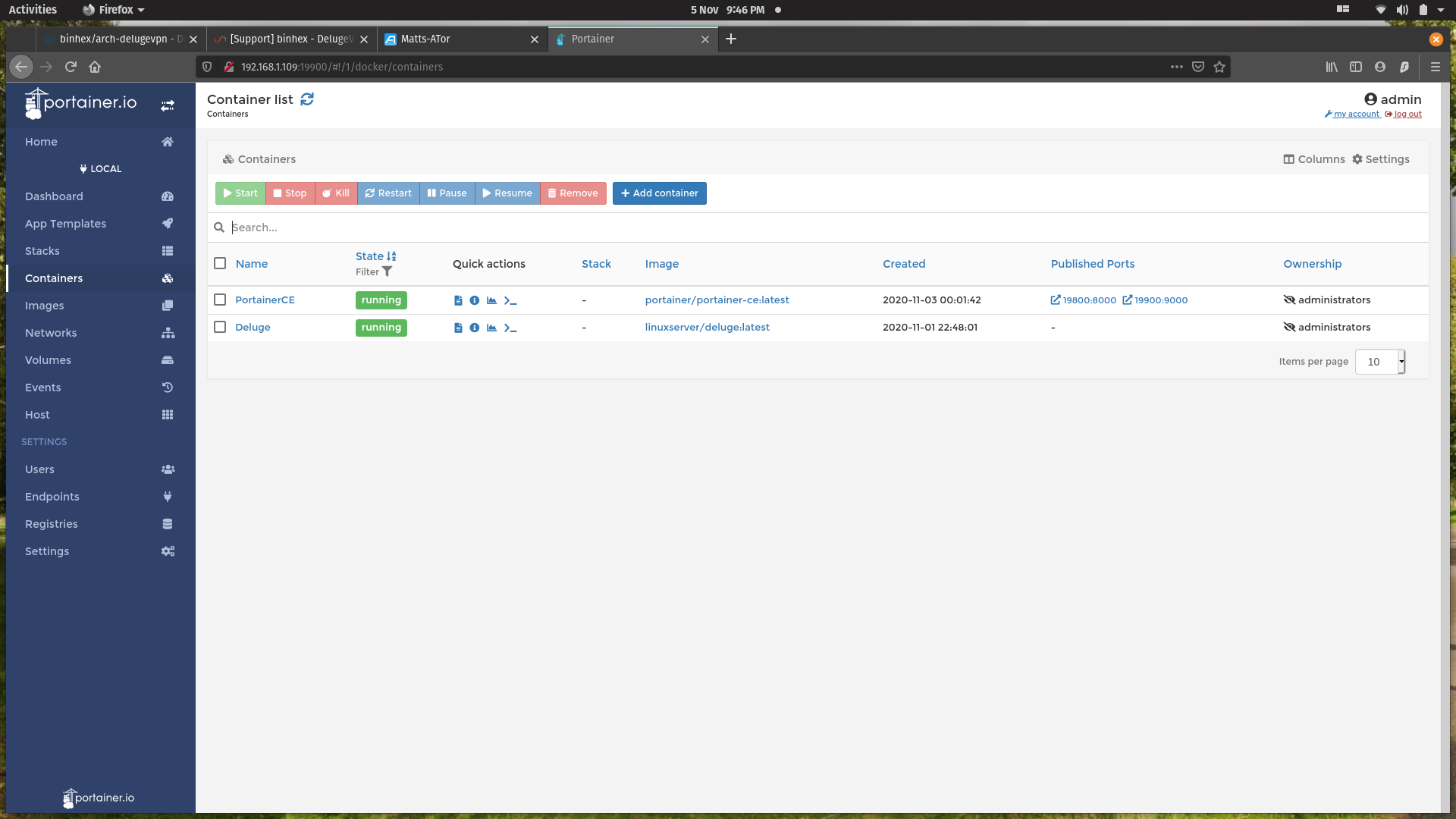

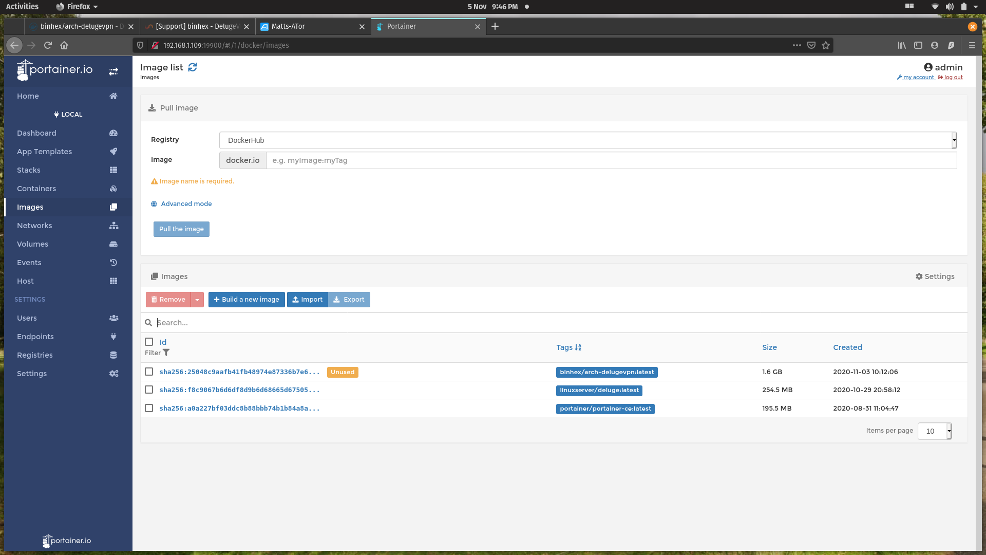

Not familiar w/ Portainer, but looking at screenshots, I would think it is in the Container section under the DelugeVPN settings, but I may be way off.
any other / better dashboard i can use / you prefer? do keep in mind i am limited to a small amount of apps that is supported by ADM OS.
Within Portainer, there is a container section, bu i only have Deluge and PortainerCE in there.
DelugeVPN i have ONLY pulled in, so it is under images, but there, there is still a notification "unused". and i think i can not use it till i have this solved, right?
Please see screenshots.
