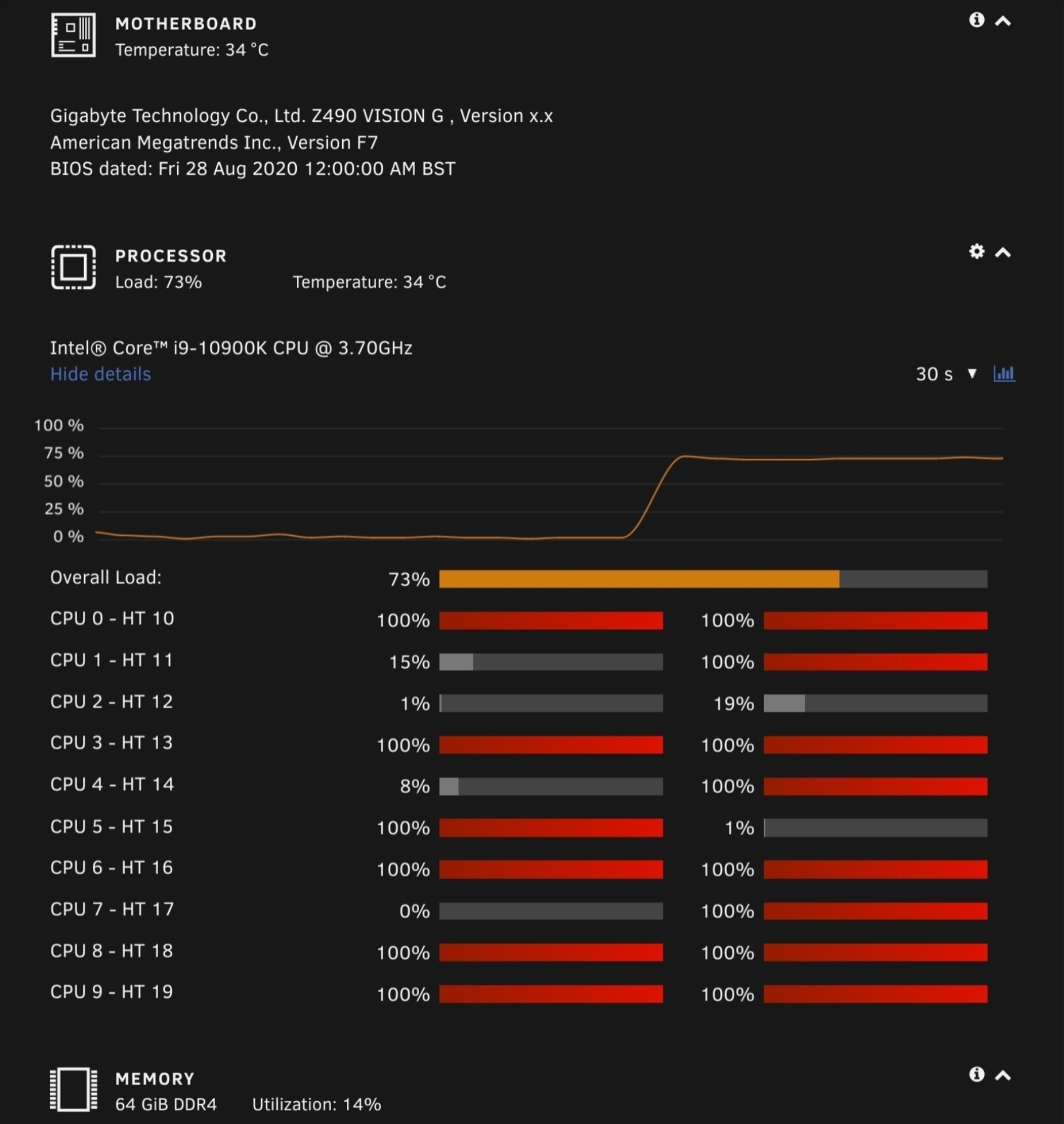

Once SAB has finished a download, the system resources are maxed out and the system hangs whilst it unpacks and moves the file to its final location. Sometimes Sabnzbdvpn will crash and restart.
I have a couple of mechanical HDD's that my movies are downloaded to and ultimately stored on. I also have an NVME cache drive, however I don't seem to have that set to be used by SAB. I do note however that when the system hangs, the NVME write count shoots up. Maybe this is somehow part of, or is, the problem.
Any suggestions would be greatly appreciated.

On 9/24/2022 at 10:15 AM, BeardedNoir said:
Hello all, I'm having an issue with Sabnzbdvpn and I was hoping someone could tell me what I'm doing wrong.

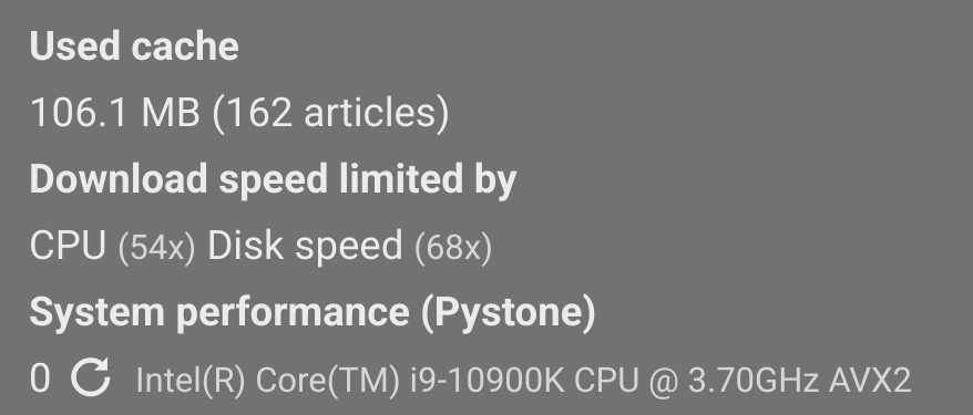

Looking in Sabnzbd status page, it shows the below, specifically that my CPU and Disk Speed are limiting my download speed. Could this indicate the issue does anyone believe?
Edited by BeardedNoir

On 10/1/2022 at 12:46 PM, BeardedNoir said:
Many thanks for the suggestion. I've just updated to the latest however its still bringing my whole sever to a grinding halt, even causing Sabnzbd to restart sometimes. So frustrating. I have no idea what is causing it, nothing else is running.
I have not tried that latest release on 6.11.0. Have you updated unRAID yet? I have but not the docker container :P I have too much in que still since this is a new server
Hello buddy, yeah I'm running the latest unRaid build, no issues, other than the above but I had that before the upgrade.
