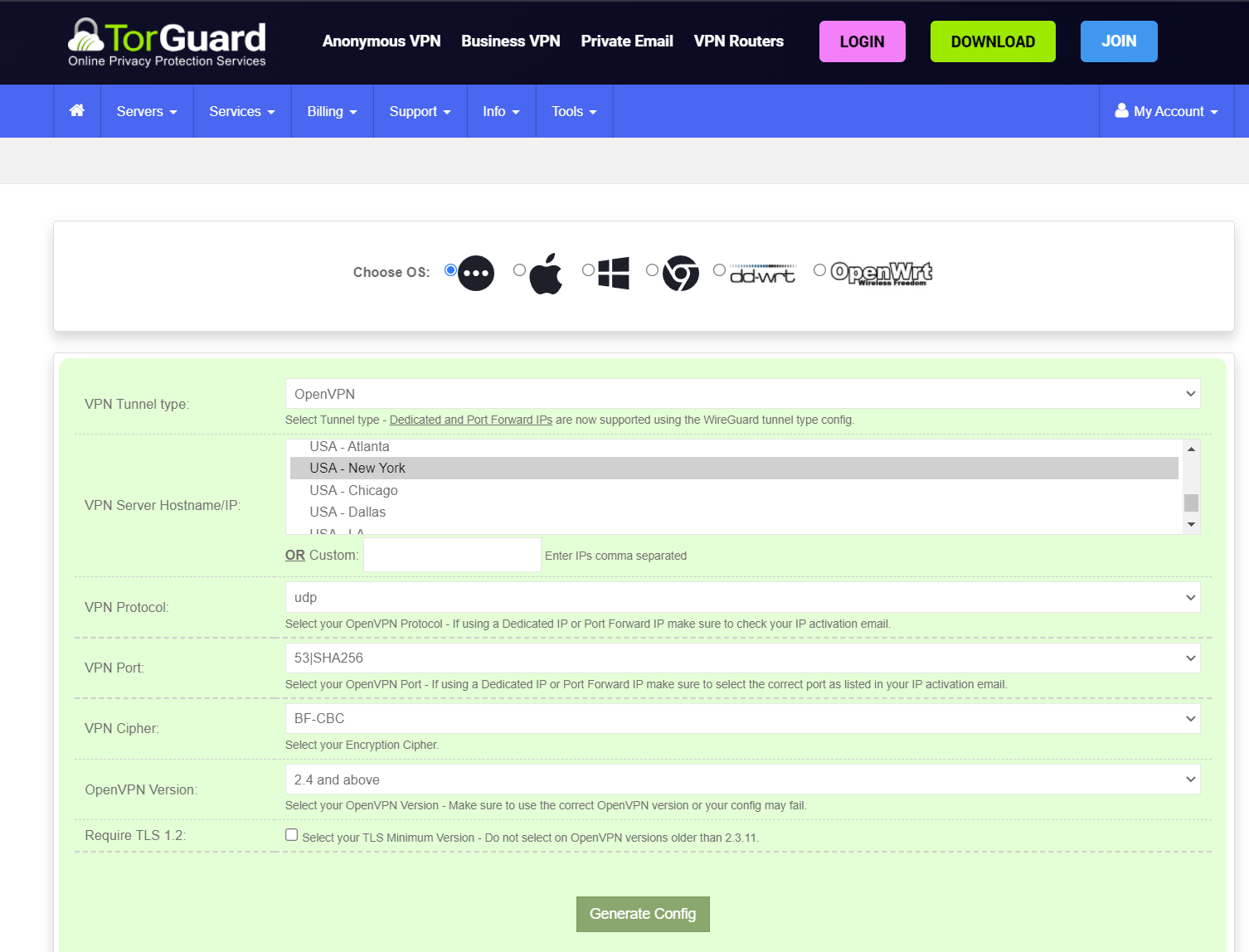

I'm getting maybe 15-30 MB/s out of this setup with TorGuard. Is there a recommended config for this?  I would normally max my GiG connection out without the VPN.  Even 1/2 that speed would be nice.
Edited by dja

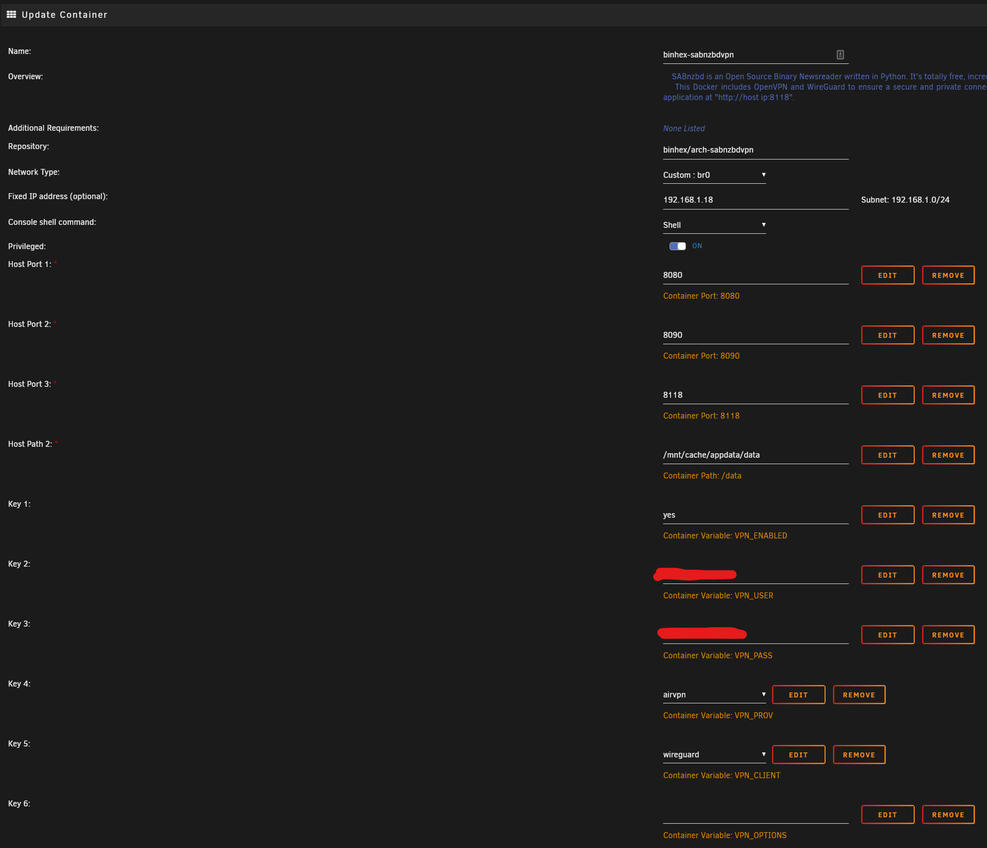

Hi All
@binhexThank you so much for your containers. I am definitely buying you a couple of beers.
I have a minor issue, I am trying to run both binhex-delugevpn and binhex-sabnzbdvpn. Both are setup to connect to PIA via Wireguard and use the corresponding default wg.conf. However, once I start one of the containers, the other one won't start. Any idea why?
Hi All
Most probably a port clash on the host side make sure you have unique host ports for each container
Sent from my CLT-L09 using Tapatalk
On installations from CA there should also be a popup showing if there is a port clash on the host side
If in doubt, the docker run command for the app which won't start will tell you exactly why (if you see an execution error when trying to start it)
