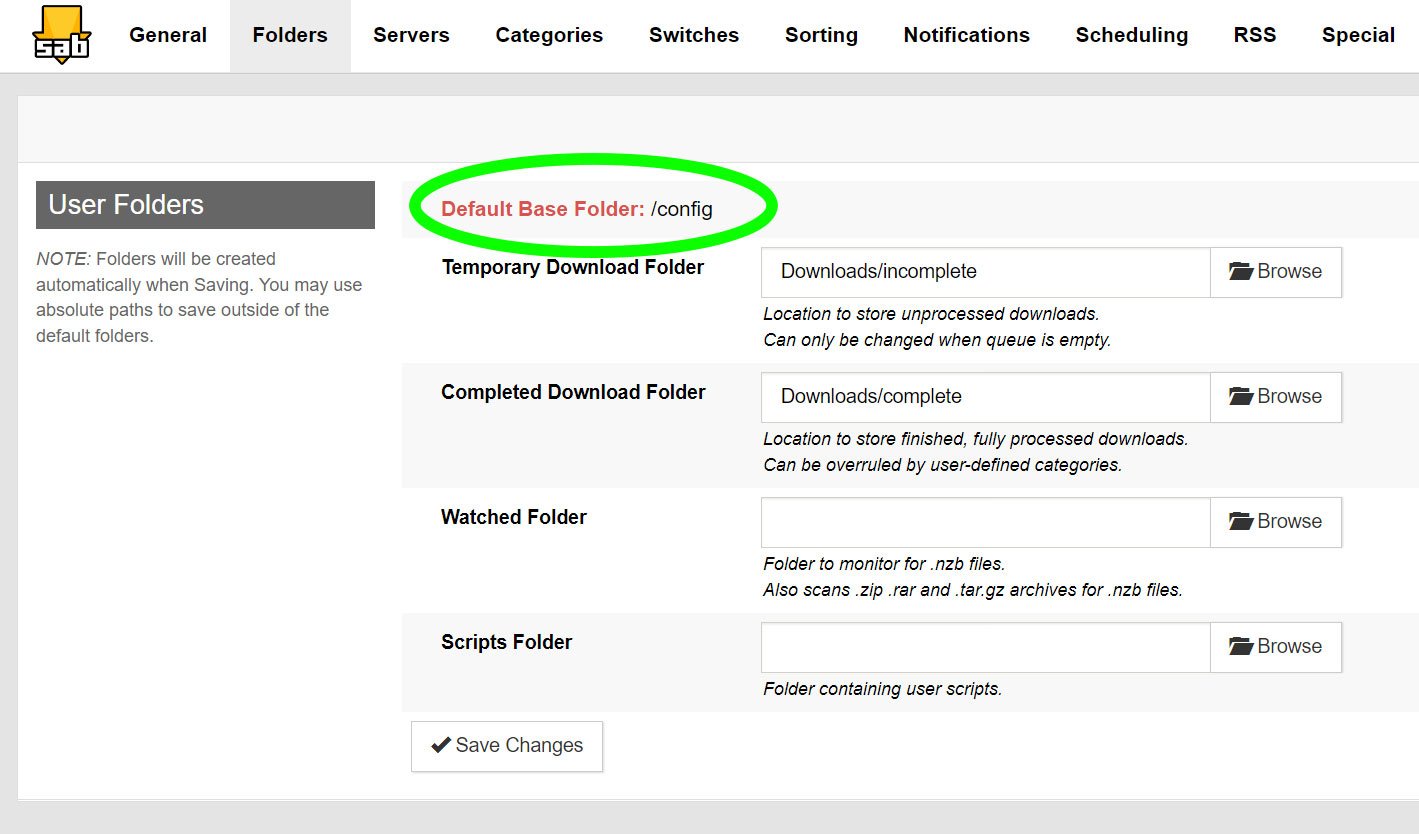

I am unable to write to /data/complete directory. No clue what changed but files download properly but the postprocessing script fails to write files to /data/complete due to a permissions issue.

I was able to fix this, some how permissions had changed on /data/complete to root. chown -R nobody:users /data/complete seems to have fixed this for me
