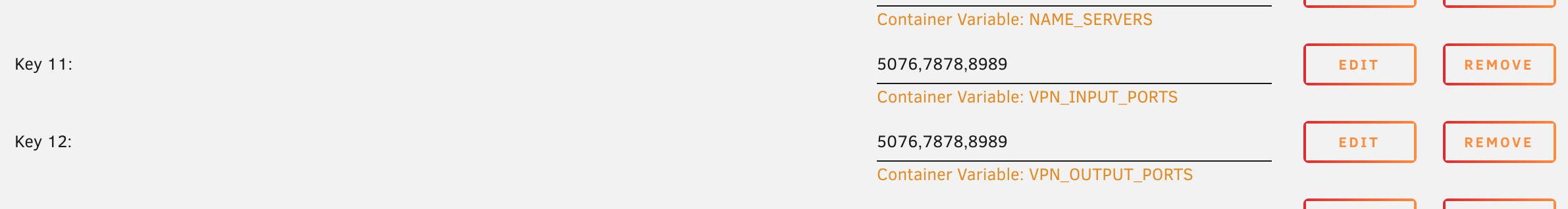

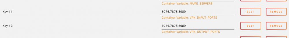

The only issue I’m still having is that I can no longer reach radarr (port 8989), sonarr (7878), nzbhydra2 (5076) outside my network using my reverse proxy. I used @SpaceInvaderOne tutorial to setup a reverse proxy using Swag and creating a proxynet and after the vpn updates I get a “502 bad gateway” error when trying to access those containers.
I tried Q27 in the docs and added each of the ports above to VPN_OUTPUT_PORTS but no luck so far.

Hi @binhex, any ideas on how to get this new setup working with a reverse proxy? I've added each of the ports above and couldn’t find any suggestions in the documentation or anywhere else in this thread.
Is it still possible to use a reverse proxy?

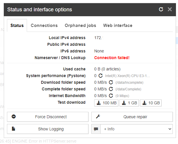

Greetings, I have been using binhex SABnzbdvpn for about a year on unraid with great success, about a month ago it started to generate a couple errors (included in log), during this time it didnt change how everything came in so I hoped a future update would correct the issue. About two weeks ago any file will get hung up on a scan or DL at 99% but show full file size in the progress bar and never complete. I am not sure what is interconnected with this issue or not, I have restarted from scratch on SABnzbd and still have the same issue. Is this a network thing that happened on my end? not sure what changed or needs to change, any and all help is appreciated.
sabnzbd-log-error.txt
Can you post logs from your docker container along with your docker settings? I didn't get much from what you posted.
Please see the docker cut out for the common error and the settings file from SAB. If there is anything else needed please let me know and I will get it submitted.
Docker-Log.txt sabnzbd-log-settings.txt
