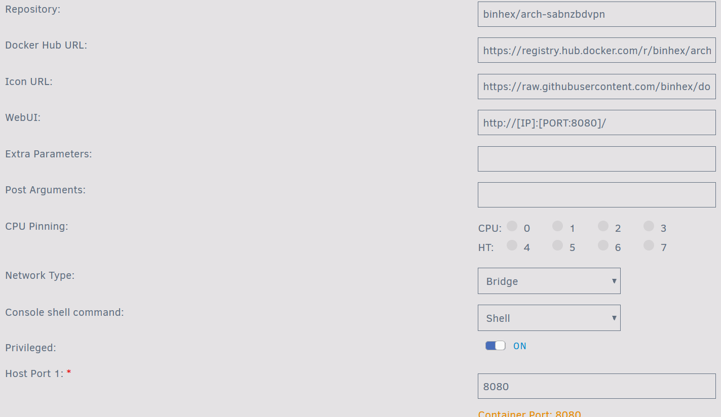

No, it's been running on port 8080 for months.  I verified I'm hitting it at :8080 and that the config shows 8080.
(see attached config)

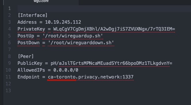

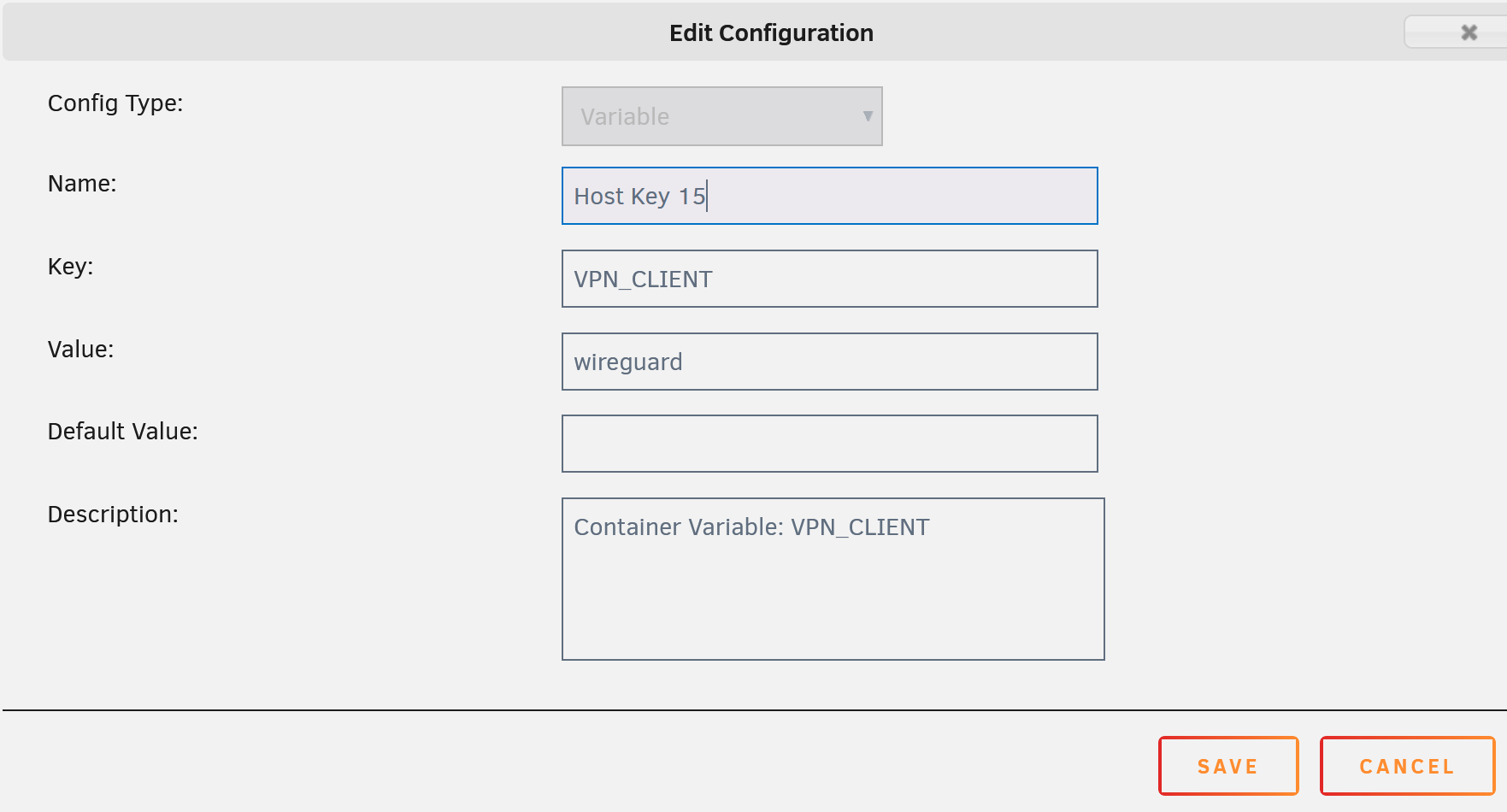

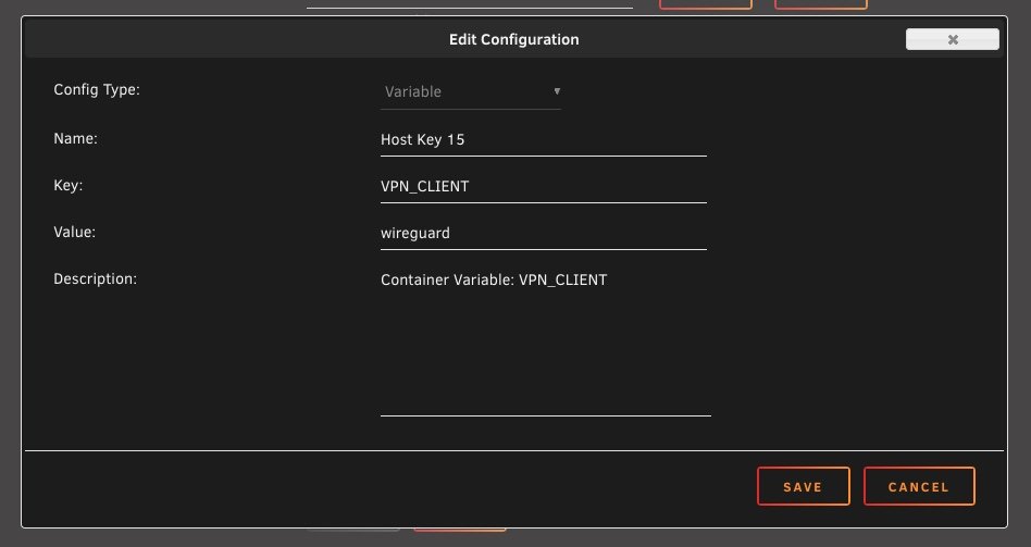

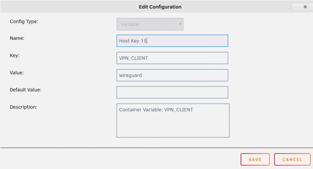

try switching to wireguard.
1.   Right click "Edit" the SABnzbdvpn container.
2.  Add "variable" with the following information.
3.  Click apply to pulldown the container change.  The default PIA endpoint for this container is the Netherlands.  You can also pick any other end point from here.
4.  When changing endpoints, shutdown SAB.
5.  Navigate to your /appdata/binhex-sabnzbdvpn/wireguard/wg0.conf .
6.  Open "wg0.conf" in a text editor, like Atom, the open source text editor.
7.  Change underlined part below to the appropriate endpoint from the link above based on country/location.
8.  Click "Save" in your text editor.
9.  Restart SAB.
9.  Restart SAB.

the only thing that differed from your instructions was that the new variable asked for both a VALUE and a DEFAULT VALUE.  I put 'wireguard' in VALUE and left DEFAULT VALUE empty (I also tried just 'wireguard' in the DEFAULT VALUE field, same impact)

you're looking at your "edit" screen in advanced mode, that's why you're seeing the "default value" field.  it doesn't matter.

I must be an idiot, because I've forced an update to the docker, and still cannot access it.  Log attached, from after turning off VPN option.  Have tried privoxy on/off.  Port should be 8081, not sure why it says 8080
supervisord.log
what do you mean by this?, you didnt change the container port by any chance did you?, if so you shouldnt do that, you change the host port not the container port.
