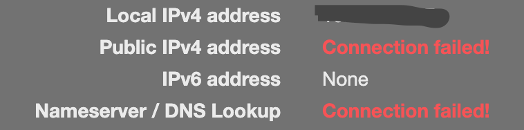

I continue to see Auth_Failed, however the same credentials were used to login via web interface to confirm and work on other machines on my network. Any suggestions on how to get past this issue?
