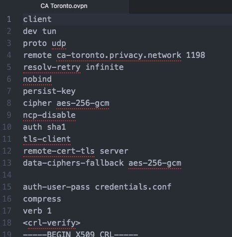

Update: i just updated binhex-sabnzbdvpn to the latest, which broke my vpn connection.  got an error message saying to add "aes-256-gcm" to fallback.  so, despite the recommendation in Q22 to remove "data-ciphers-fallback aes-256-gcm," i added back "data-ciphers-fallback aes-256-gcm" to the ovpn file and was instantly able to login.  your milage may vary.
this will work, but not for all endpoints, so it depends what you connect to, the settings in Q22 seem (at least in my testing) to work with most (if not all) PIA endpoints.
to be clear, i had the exact settings from Q22 in ovpn file working for Toronto.  then i updated today to the latest SAB which broke it.  i then monitored the sab logs and followed the recommendation.
Edited by DoItMyselfToo
i would of liked to of seen that log as i doubt it was related to the cipher, i would suspect some other transient issue
Edited by binhex
this is what i had (excepting line13); had a working SAB.
updated SAB.  received AUTH_FAILED and this below:
DEPRECATED OPTION: --cipher set to 'aes-256-gcm' but missing in --data-ciphers (AES-256-GCM:AES-128-GCM). Future OpenVPN version will ignore --cipher for cipher negotiations. Add 'aes-256-gcm' to --data-ciphers or change --cipher 'aes-256-gcm' to --data-ciphers-fallback 'aes-256-gcm' to silence this warning.
so added line 13; instantly worked.
