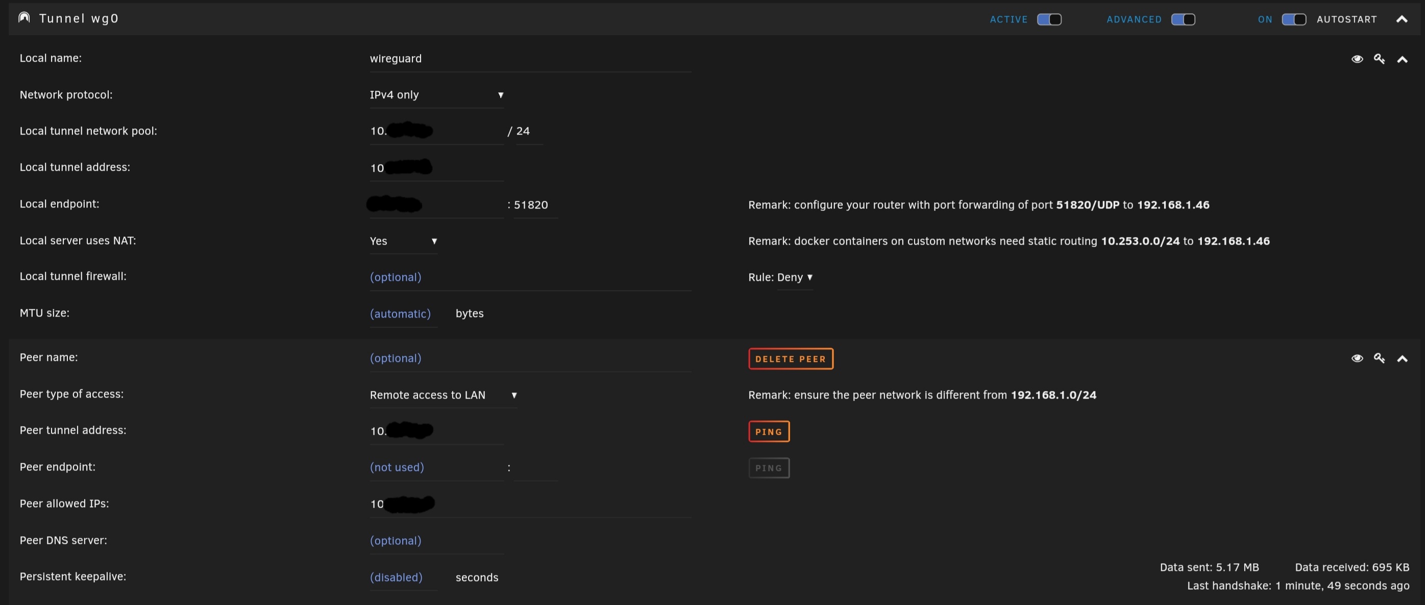

I thought I would post here as my issue seems to be Sabnzbdvpn specific.
I am utilising Wireguard to access my UNRAID remotely and can fire up all dockers and use them as if I was local, except for Sabnzbdvpn, it just times out.
Sabnzbdvpn is configured the same as the other Binhex containers in that it uses a custom network so they can all talk to one another, and I'm able to access them the same as any other container, except for Sabnzbdvpn.
I'm sure this is a simple error on my behalf, but if anyone can advise, it will be greatly appreciated.
Thanks.
Thanks.
I'm actually fighting with the same problem, I just set up wireguard and can access any container not under a binhex-VPN enabled container. There is a FAQ to address this here under Q2: https://github.com/binhex/documentation/blob/master/docker/faq/vpn.md
My issue is that I did add that script to my go file and also enable it immediately with /sbin/modprobe iptable_mangle , but I still cant access the containers.
Is there any way to debug and see if the connection attempt is happening and where it is failing? :(
most probably you need to add your wireguard network to the LAN_NETWORK env var for sabnzbdvpn, otherwise it will be blocked when you are on the vpn, if you want more than one network then use a comma to seperate the values.
Worked first go, many thanks as always. 👍🏻
This fixed my issue as well, thanks a ton!
