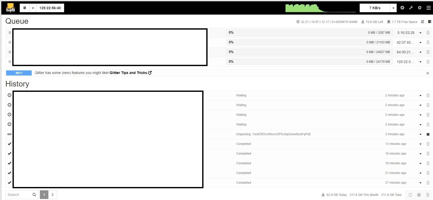

Can someone help me understand what's happening? This happens pretty often, where nothing happens when a file is post processing, eventhough I don't have "Pause Downloading During Post-Processing" selected. Any thoughts?
