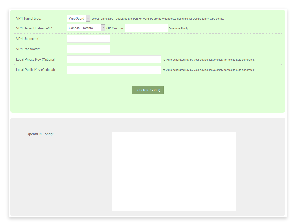

Wireguard support got added and it's working great so far! Only issue I have is when I change the endpoint to a specific WG Server IP rather than a hostname it seems to fail? Is there any way to select a specific server IP? Thanks!
I used the script: https://github.com/pia-foss/manual-connections
To find a wireguard IP since my provider wants a static IP. And then I used that in place of the hostname for ENDPOINT in the conf file.
Edited by AD24

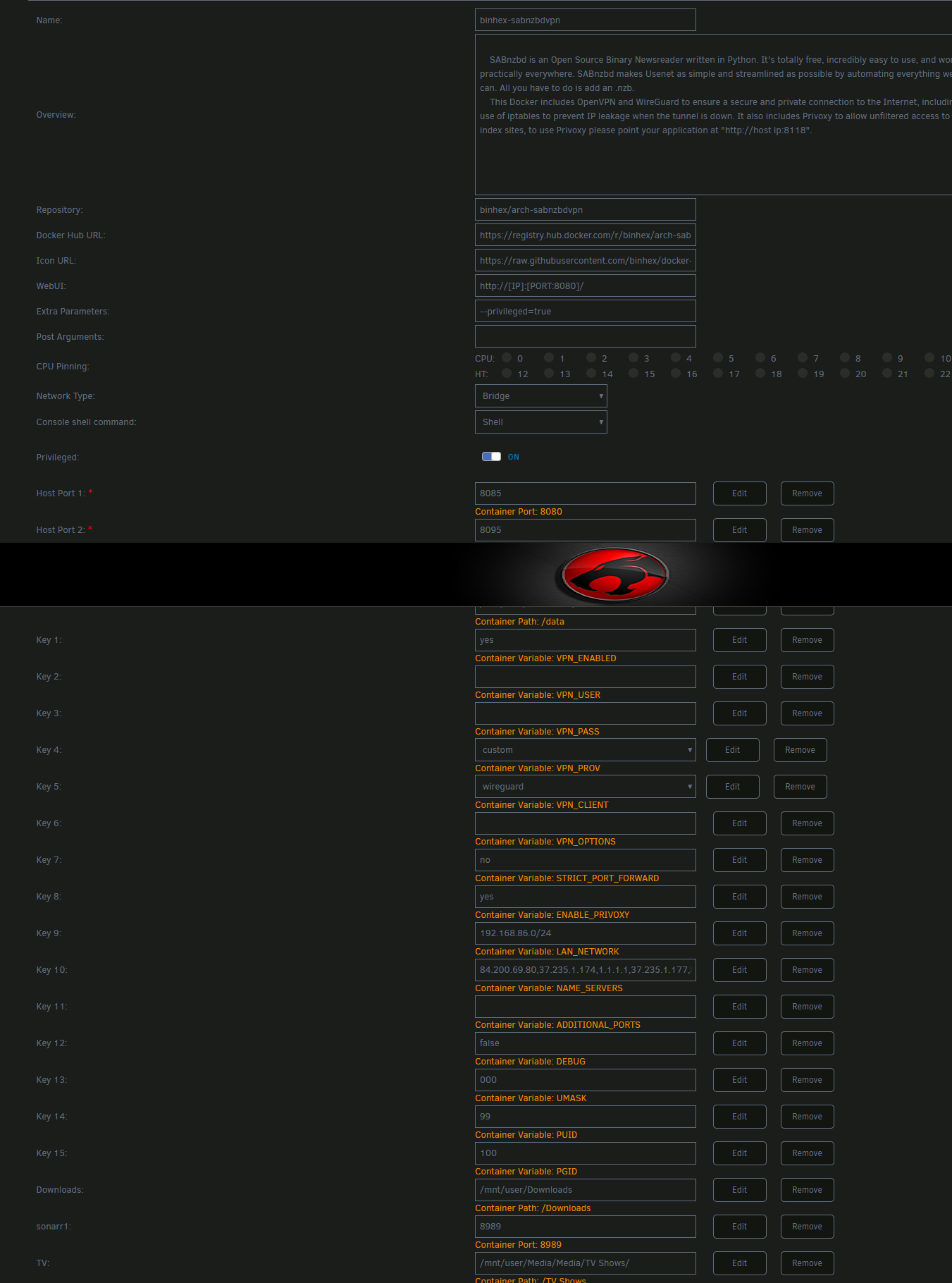

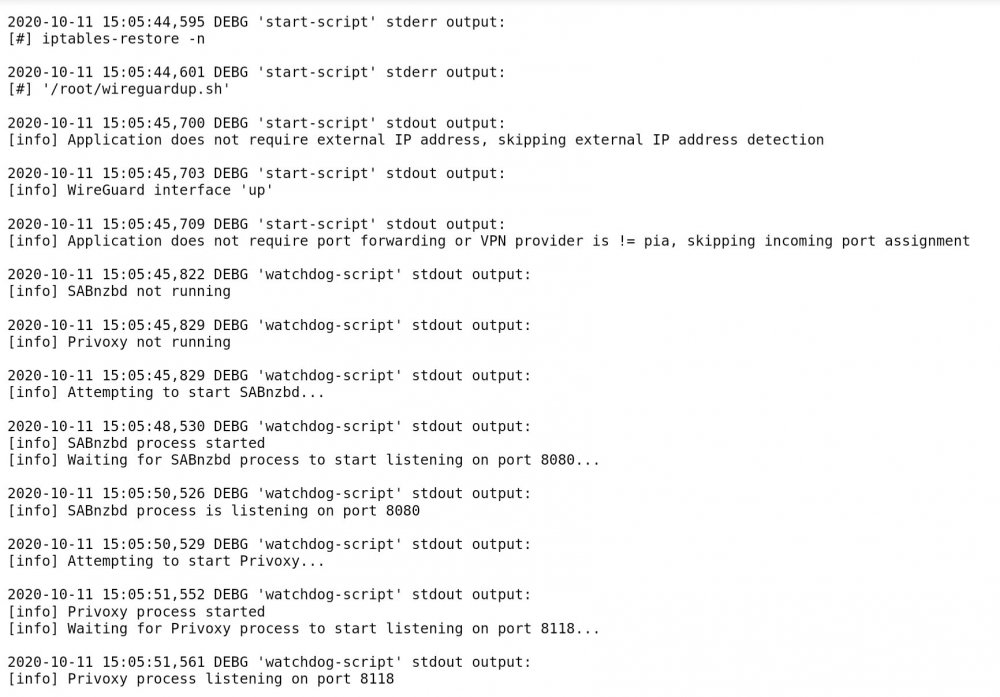

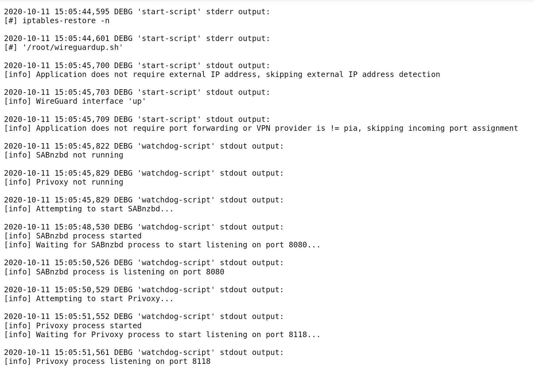

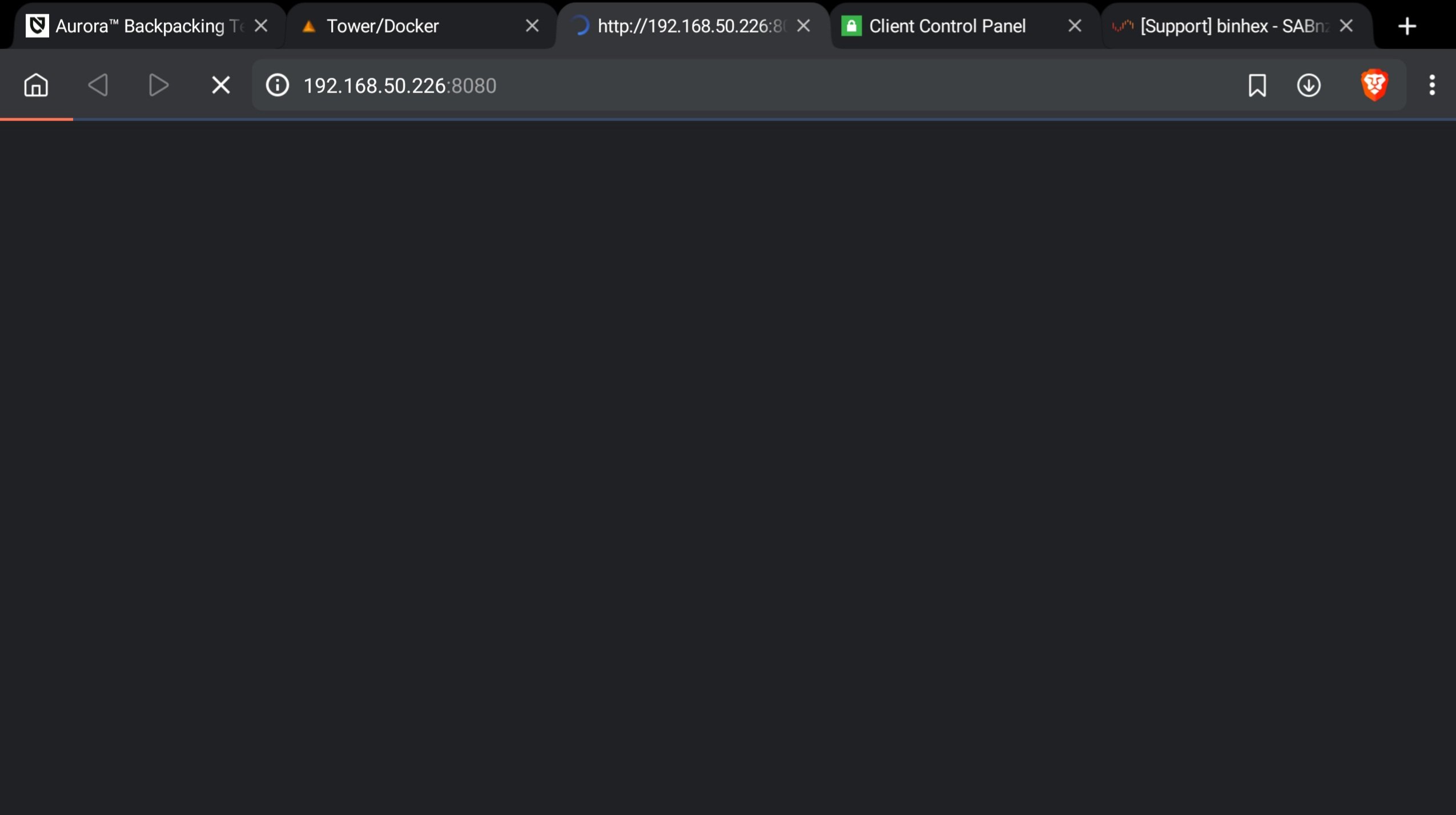

I spotted over on the DelugeVPN thread that WireGuard had been implemented and so I've taken out a month subscription with PIA to try it out.
Everything seemed to go well however once SabnzbdVPN starts in the log, I can't get the GUI to load? I don't see any errors in the log and so I was hoping someone could shed some light?
Many thanks.
SabnzbdVPN log;
GUI won't load;
My SabnzbdVPN settings;
***Edit - DOH.....I didn't update the lan_network address (I've recently moved house), all working now.

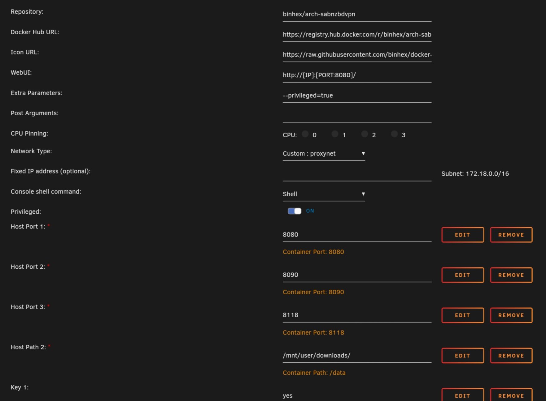

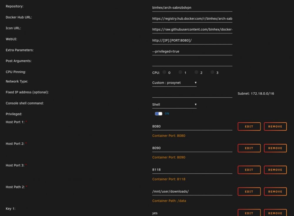

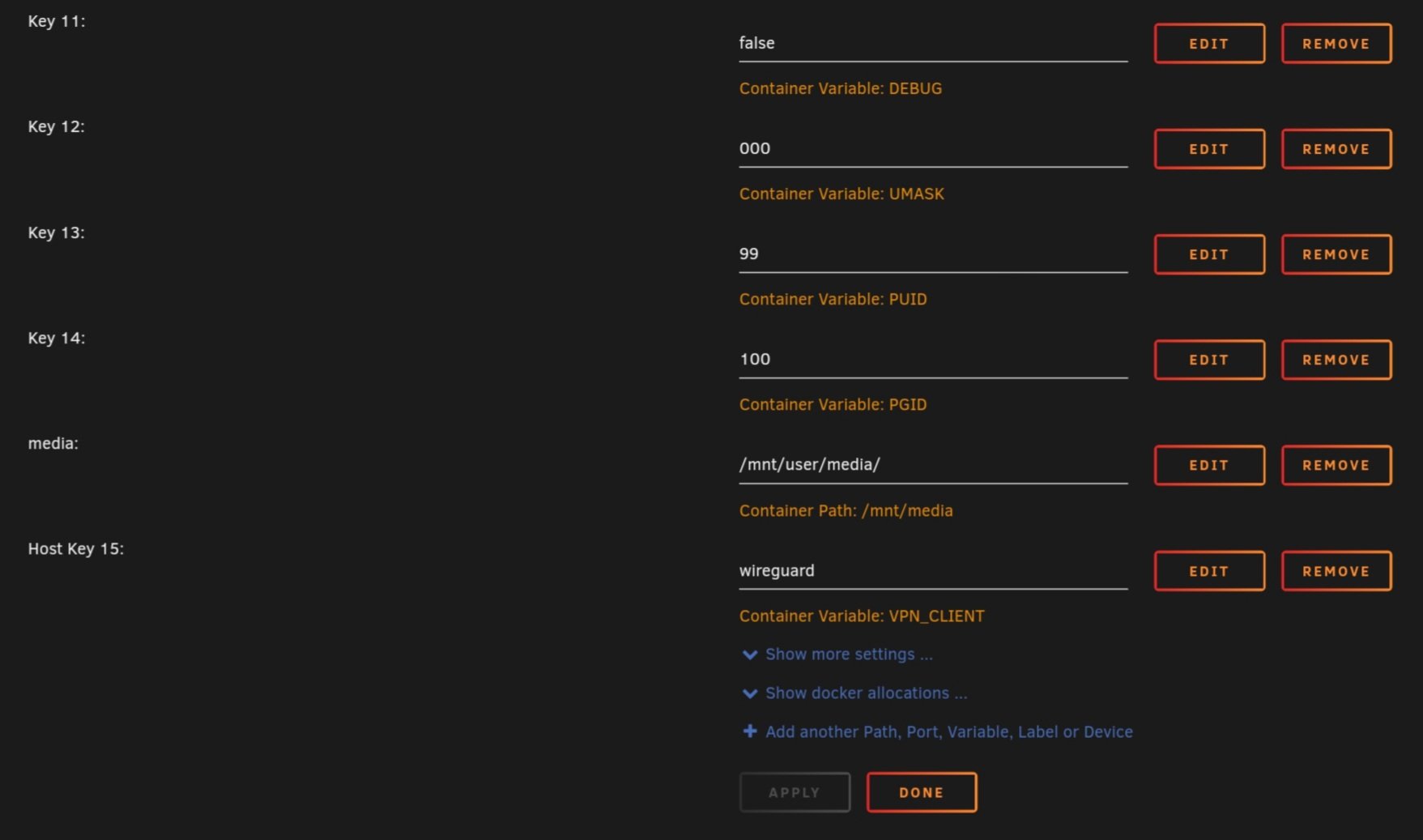

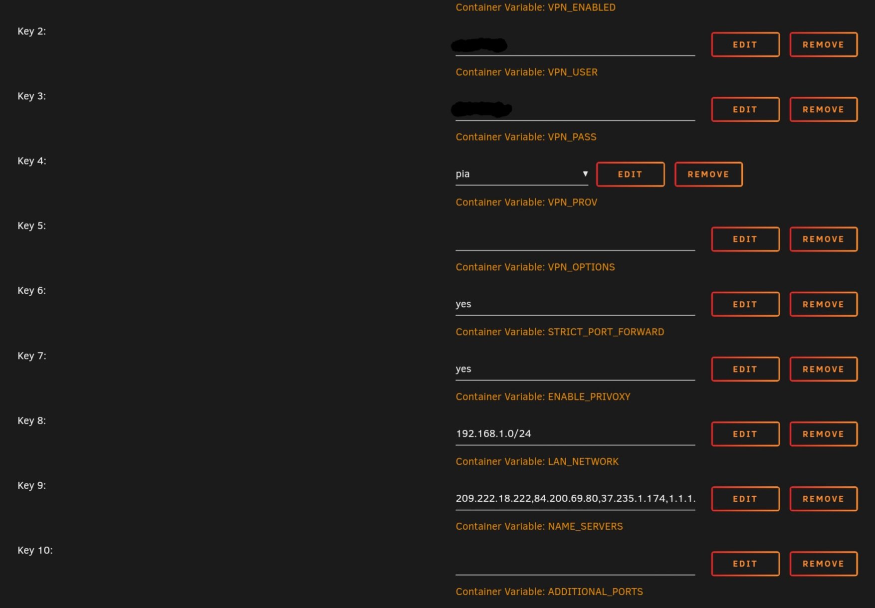

I'm attempting to utilize the new wireguard setup after a successful openvpn setup.  I use Torguard for my VPN service.  I have wireguard selected and I utilized the tool here https://torguard.net/tgconf.php?action=vpn-openvpnconfig for creating a wireguard config from Torguard.  I entered in my details as requested to generate the config.  I then started and stopped wireguard service and replaced the information in the wg0.conf file w/ my config information.  I verified that the information stays after booting up the container.  I also updated "Extra Parameters" to be "--privileged=true".  The container starts buts that is all I get.  I attached a screenshot of my settings w/ user and pwd temporarily removed.  I would appreciate any assistance.  Thank you in advance.
