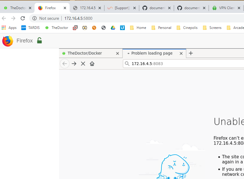

Thank you I am on a ethernet connected machine on the same subnet no VLan or Firewall and I even rebooted the UNRAID Host
8 minutes ago, rguinn said:
@binhexThank you I am on a ethernet connected machine on the same subnet no VLan or Firewall and I even rebooted the UNRAID Host
Also DL the docker for firefox on the host and attempted to connect
Edited by rguinn

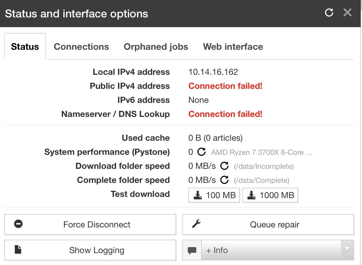

Out of the blue, I can no longer access the UI via IP address etc. Just says connecting... and never loads the UI. Clearly I've messed something up somewhere. What's the proper way to remove my existing install, including appdata contents, and start again?
Same Here ! before wiping it out can you do a debug and upload the log just incase there a bigger problem and @binhexcan review
Already wiped, using CA tools, and reinstalled. Working fine after I did that

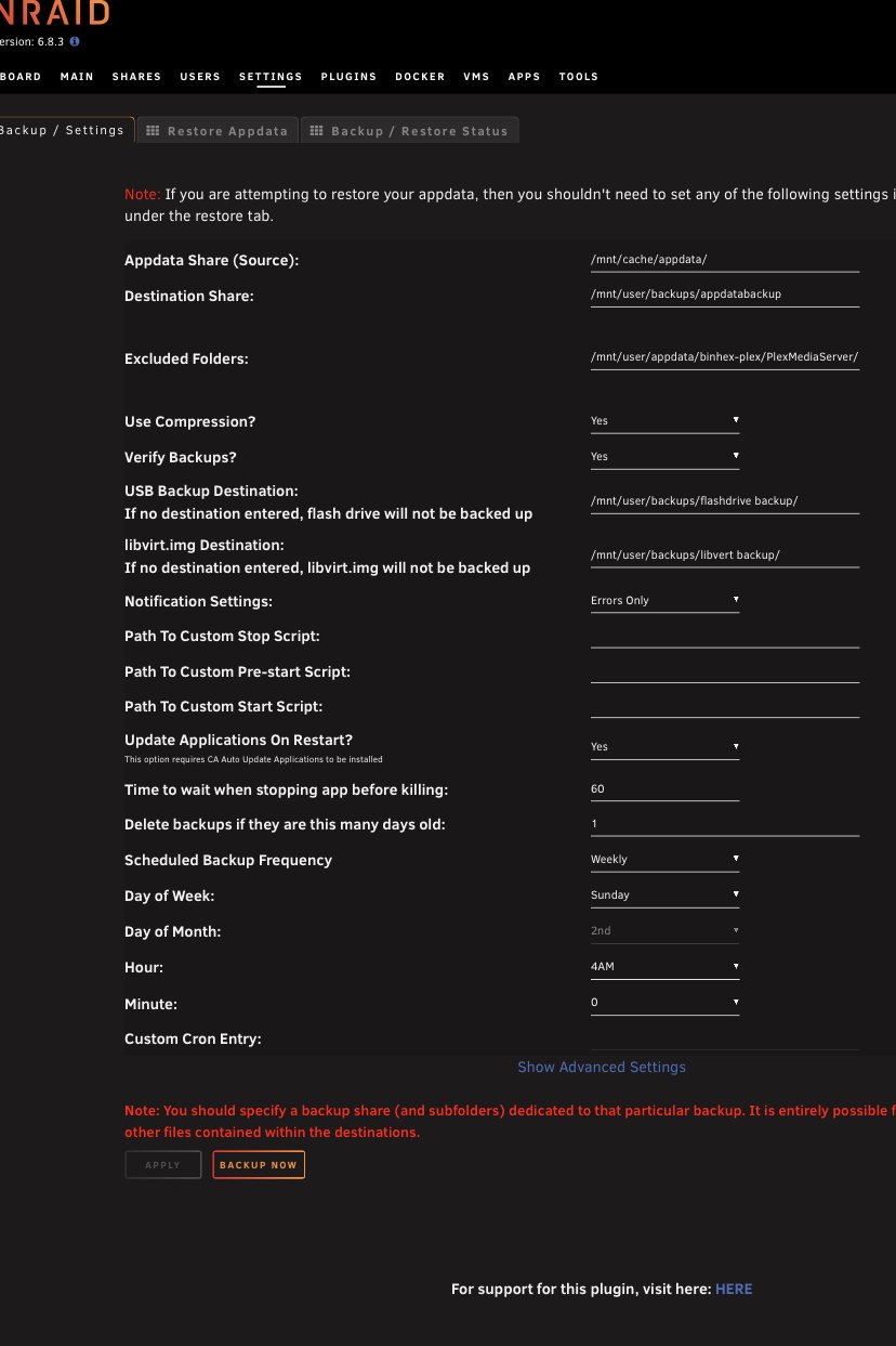

I have my system set up to back up docker containers every Sunday morning. However, without fail I seem to get a ‘connection failed’ error within SABnzbdVPN upon the container restarting. Frustrating as none of the other containers that rely on the proxy will work either, until I go in and manually restart SABnzbdVPN.
Any ideas what might be causing the connection failed? I have a working system otherwise.
I have added some logs which I think may show the issue:
that depends on how you have it set, i believe there is an option to 'pause' containers during backup, you must NOT use this option with any of my vpn docker images as they will not play nicely with pause/resume, you have to perform a shutdown of the container, backup, then a startup.
Thanks for the quick response - I shall take a look though I do think CA Auto Update Applications does shutdown, instead of pausing.
CA Auto Update is not used for backups,  that is used to auto update apps, the backup plugin is called 'CA Appdata Backup/Restore v2', check the settings.
Yeah. Wrong plugin. I will take a look at the settings when I finish work.

So this is still happening every Sunday morning and I’m at a loss as to why.  The setting within ‘CA Appdata Backup/Restore v2’ are as below. Looks ok to me and no other app has this issue.

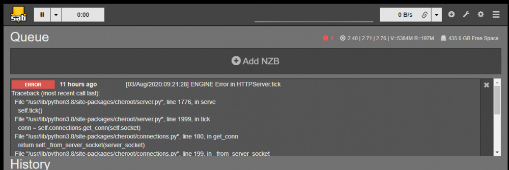

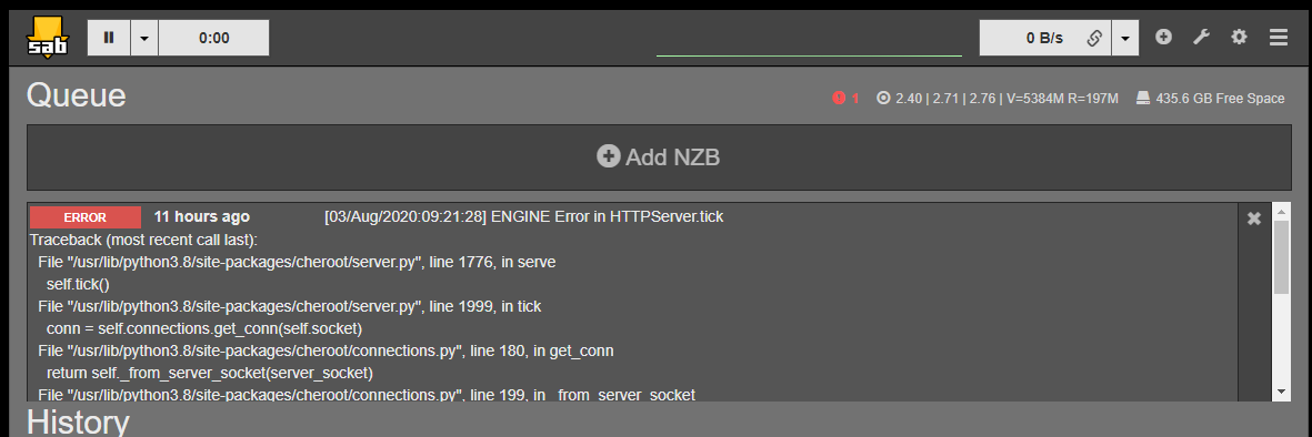

Since the latest update I've been getting this error. Any idea?
ERROR 11 hours ago [03/Aug/2020:09:21:28] ENGINE Error in HTTPServer.tick
  File "/usr/lib/python3.8/site-packages/cheroot/server.py", line 1776, in serve
    self.tick()
  File "/usr/lib/python3.8/site-packages/cheroot/server.py", line 1999, in tick
    conn = self.connections.get_conn(self.socket)
  File "/usr/lib/python3.8/site-packages/cheroot/connections.py", line 180, in get_conn
    return self._from_server_socket(server_socket)
  File "/usr/lib/python3.8/site-packages/cheroot/connections.py", line 199, in _from_server_socket
    s, ssl_env = self.server.ssl_adapter.wrap(s)
  File "/usr/lib/python3.8/site-packages/cheroot/ssl/builtin.py", line 243, in wrap
    s = self.context.wrap_socket(
  File "/usr/lib/python3.8/ssl.py", line 500, in wrap_socket
    return self.sslsocket_class._create(
  File "/usr/lib/python3.8/ssl.py", line 1040, in _create
    self.do_handshake()
  File "/usr/lib/python3.8/ssl.py", line 1309, in do_handshake
    self._sslobj.do_handshake()
ssl.SSLError: [SSL: VERSION_TOO_LOW] version too low (_ssl.c:1108)
looks like this is a match:-
https://github.com/sabnzbd/sabnzbd/issues/1437
it looks like its cherrypy spewing the error but that issue above is not clear on how to fix it other than switching sabnzbd to pyopenssl, which cant be easily done as its hard coded to use builtin. i think the error maybe caused by accessing the web ui over https, if that is the case trying switching to plain http and see if the error continues.
Sabnzbdvpn runs without problems when I set the network settings to "Bridge".
If I go to "br0" here to get an IP address different from the host, the web interface doesn't work anymore or can't be accessed.
Sabnzbd and Privoxy are listening on the correct ports when I look at the log, but the web interface is not accessible and a portscan only shows that Privoxy is running.
2020-07-19 07:51:40,542 DEBG 'start-script' stdout output:
Sun Jul 19 07:51:40 2020 ROUTE6: default_gateway=UNDEF
Sun Jul 19 07:51:40 2020 OpenVPN ROUTE6: OpenVPN needs a gateway parameter for a --route-ipv6 option and no default was specified by either --route-ipv6-gateway or --ifconfig-ipv6 options
Sun Jul 19 07:51:40 2020 OpenVPN ROUTE: failed to parse/resolve route for host/network: fc00::/7
Sun Jul 19 07:51:40 2020 OpenVPN ROUTE: failed to parse/resolve route for host/network: 3000::/4
Sun Jul 19 07:51:40 2020 OpenVPN ROUTE: failed to parse/resolve route for host/network: 2000::/4
Sun Jul 19 07:51:40 2020 OpenVPN ROUTE: failed to parse/resolve route for host/network: ::/3
Sun Jul 19 07:51:40 2020 TUN/TAP device tun0 opened
Sun Jul 19 07:51:40 2020 TUN/TAP TX queue length set to 100
Sun Jul 19 07:51:40 2020 /usr/bin/ip link set dev tun0 up mtu 1500
2020-07-19 07:51:40,543 DEBG 'start-script' stdout output:
Sun Jul 19 07:51:40 2020 /usr/bin/ip addr add dev tun0 10.32.208.193/24 broadcast 10.32.208.255
2020-07-19 07:51:40,544 DEBG 'start-script' stdout output:
Sun Jul 19 07:51:40 2020 /root/openvpnup.sh tun0 1500 1553 10.32.208.193 255.255.255.0 init
2020-07-19 07:51:40,660 DEBG 'start-script' stdout output:
[info] Application does not require port forwarding or VPN provider is != pia, skipping incoming port assignment
[info] Checking we can resolve name 'www.google.com' to address...
2020-07-19 07:51:40,663 DEBG 'start-script' stdout output:
[debug] Having issues resolving name 'www.google.com', sleeping before retry...
2020-07-19 07:51:45,599 DEBG 'start-script' stdout output:
Sun Jul 19 07:51:45 2020 /usr/bin/ip route add 134.19.179.242/32 via 172.17.0.1
2020-07-19 07:51:45,600 DEBG 'start-script' stdout output:
Sun Jul 19 07:51:45 2020 /usr/bin/ip route add 0.0.0.0/1 via 10.32.208.1
2020-07-19 07:51:45,601 DEBG 'start-script' stdout output:
Sun Jul 19 07:51:45 2020 /usr/bin/ip route add 128.0.0.0/1 via 10.32.208.1
2020-07-19 07:51:45,602 DEBG 'start-script' stdout output:
Sun Jul 19 07:51:45 2020 WARNING: OpenVPN was configured to add an IPv6 route over tun0. However, no IPv6 has been configured for this interface, therefore the route installation may fail or may not work as expected.
 So still having this issue and at a loss to why. Looking at the Unraid logs and not just the docker logs the following is noted:
Aug 16 07:16:10 Tower kernel: docker0: port 6(veth2477b33) entered disabled state
Aug 16 07:16:10 Tower kernel: device veth2477b33 left promiscuous mode
Aug 16 07:16:10 Tower avahi-daemon[5008]: Withdrawing address record for fe80::e09d:52ff:fe52:f7eb on veth2477b33.
Aug 16 07:16:10 Tower kernel: docker0: port 6(vethd37a551) entered blocking state
Aug 16 07:16:10 Tower kernel: docker0: port 6(vethd37a551) entered disabled state
Aug 16 07:16:10 Tower kernel: device vethd37a551 entered promiscuous mode
Aug 16 07:16:10 Tower kernel: IPv6: ADDRCONF(NETDEV_UP): vethd37a551: link is not ready
Aug 16 07:16:10 Tower kernel: docker0: port 6(vethd37a551) entered forwarding state
Aug 16 07:16:10 Tower kernel: eth0: renamed from veth23107a7
Aug 16 07:16:10 Tower kernel: IPv6: ADDRCONF(NETDEV_CHANGE): vethd37a551: link becomes ready
Aug 16 07:16:11 Tower avahi-daemon[5008]: Joining mDNS multicast group on interface vethd37a551.IPv6 with address fe80::e80b:bcff:fe53:3afa.
Aug 16 07:16:11 Tower avahi-daemon[5008]: New relevant interface vethd37a551.IPv6 for mDNS.
Aug 16 07:16:11 Tower avahi-daemon[5008]: Registering new address record for fe80::e80b:bcff:fe53:3afa on vethd37a551.*.
 That’s the output when restarting the docker container manually having had the connection failed issue. I do not have IPv6 set up in the docker. Would this be cashing my issue?
