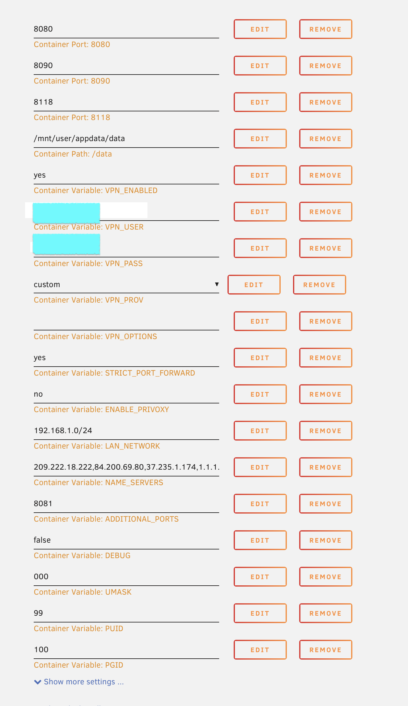

I've had this issue on and off with the sabnzbdvpn image for a while now, and just recently I've been unable to workaround it anymore.
The issue is twofold.
First, starting the image does not start sabnzbd for me. As in, there is not even an attempt to start it in the logs:

I am having some issue getting the VPN to work. If i disable the VPN and Privoxy, SAB come up fine.  If i turn on vpn, site is unreachable. Haven't even gotten to privoxy yet.  The VPN is slickvpn, as I have a deal on it.  I am using the custom setting, and have the oven file, cert file all in the right place.   User name and password are correct.  This setup works fine on my debian server, but when I try in the docker, it fails. Suggestions?  Logs attached.
-D
supervisord.log
