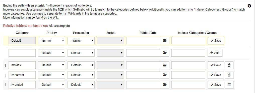

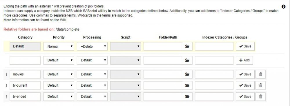

so, I don't need to setup different paths in the one running version of SABnzbd? (see SAB setup.jpg)…  My question is the "Folder/Path" section...
just leave it blank or do I have to input paths...  Also note that tying all this together, the tv-current shows are on a Asustor NAS, while the tv-ended
shows, as well as all the apps are on the UnRaid server. So the tv-current running version of Sonarr media is mapped to the NAS...  I assume that means Sonarr will do all the file moving, etc?

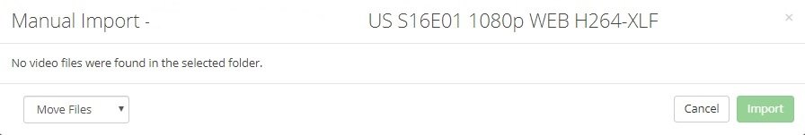

Recent update...  just tried it and after SABnzbd finished downloading the file, it wont move it to the NAS...
when I check the activity tab in Sonarr, I see this: (Soanrr error.jpg).  Weird thing is, I have Radarr setup an running
as well, and it also has to send the files to the NAS, which it does with no problems...
So for the first part. No you don't need different paths. And this is because Sonarr will only be talking to SABnzbd about the category it cares about. So if 'tv-current' had a bunch of items ready to be moved, the Sonarr instance with 'tv-ended' as it's category won't even see them in the results when it queries SABnzbd.
As for the second part, in regards to the different machine paths. SABnzbd is going to tell Sonarr where the file is located. But SABnzbd is going to say where the file is in relation to it's setup. That becomes a problem when the paths don't line up because of different machines. If you turn on the advanced settings in Sonarr, then go to download client, there is a part for remote path mappings. So you may be able to configure it through that. But would require reading up on the setup. I have it all on the same machine, so all I needed to do was line up the download paths among the Sonarr/Radarr instances and SABnzbd.
I would also expect to see an error under 'System -> Logs'
Edited by peteknot
the log shows:
"Import failed, path does not exist or is not accessible by Sonarr: /data/complete/*****************US S16E01 1080p WEB H264-XLF"
But what confuses me is Radarr is also set to move files to the NAS, and also uses the same SABnzbd that both versions of Sonarr
use...   Whenever Radarr downloads a file through SABnzbd, it moves the file to the NAS with no issues, and I don't have any remote
paths setup there...  Radarr is set to "movies" as a category in it's download client setups, just as Sonarr is set to your suggestion
of "tv-current" and "tv-ended"...

On 4/1/2020 at 7:04 PM, Squid said:
But are the PATHS on this sonarr set identically as on sab?  (The template paths, in particular the /data mapping)
Thank you...  I did have that /data path mapped to the NAS instead of the server...  now that I have changed it, it appears to be working now...
Thanks a million for your help!
